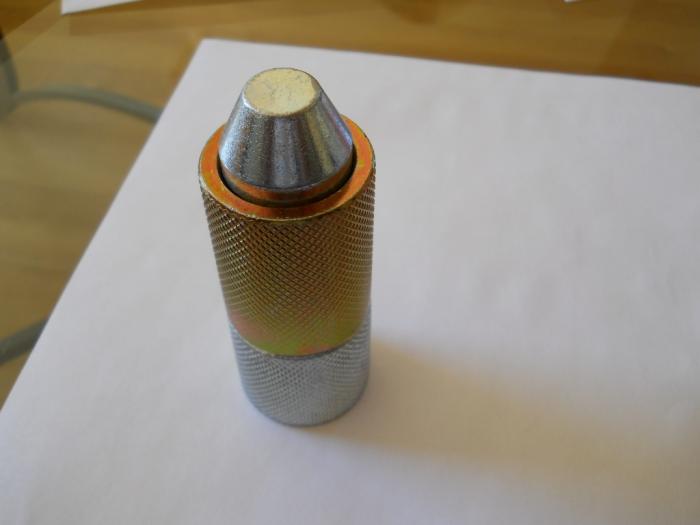

    Here is a picture of the tool I found that is the re-rounding device. I assume the outer shell is placed over the pipe, then the inner cylinder is tapped in. The instructions on the Swigtools (a similar but not identical tool) site said to use a 'food grade lubricant'. Apparently, mineral oil qualifies. I'm a little worried, though, about traces of mineral oil screwing up the sweated joint. Is soap and water enough to clean the mineral oil off the pipe? Alcohol? Any other type of solvent I should have on hand? Thanks again.
    9,003
    That swig item looks like you would need different inserts for K, L, M ???
    23,543
    It is the same as the two piece tool, and NONE of them compensate for the thinner walls of grades "L" or "M". I never use a lubricant, because that would just make soldering the joint more difficult. The one pictured will let you use the outer one and then the inner one at the same time. Most do not have a large enough opening in the female portion to let the male one slide through. This prevents the two of them from jamming on the copper and getting stuck.

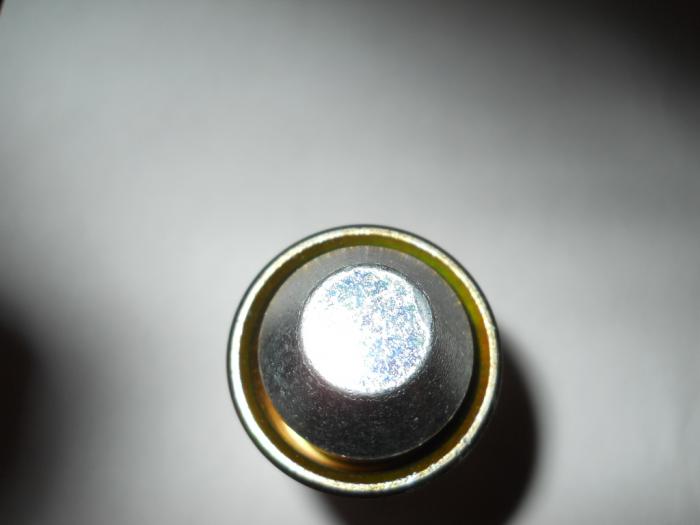

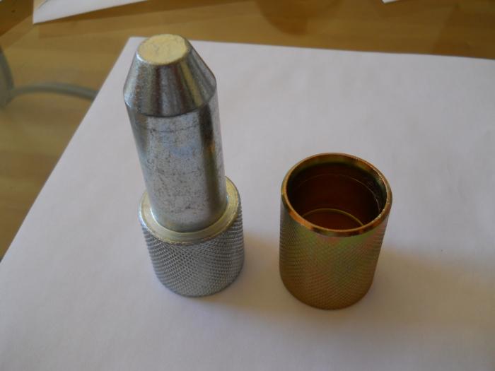

    I tried to attach another picture... this time with the female section of the tool inverted. This will show the space between the male and female which allows the presence of the pipe. So the female section is divided with two diameters -- a larger diameter to allow the pipe to be present between the male and female sections, and slightly smaller diameter that fits with a closer tolerance to the male section. The shelf inside the female section butts up against the end of the pipe. I'm still not sure, HJ, how this would prevent jamming but if you feel a lubricant is a bad idea I won't use it. Thanks again.
    Mar 2011
    Long Island, NY
    1,583
    Ahemm.........That 55 gallon drum of personal lube on Amazon is probably water soluble and food grade
    23,543
    When the two pieces are used at the same time, the thickness of the copper wall will determine whether the two pieces will bind together because of the copper tubing between them. Used one at a time it cannot happen, which is why the opening on the female side is smaller than the shaft of the male one so they CANNOT but used on the tubing at the same time.
