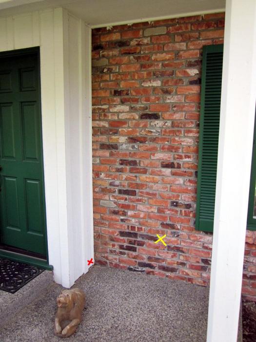

    It's time for me to get around to installing an outdoor outlet at the front of the house for seasonal usage: small water pump for the fountain, leaf blower and Christmas lights. I'd like the GFI outlets switched so that the fountain does not have to be plugged/unplugged twice a day. I'd prefer one of those weathertight boxes that cover the line cord while it is plugged in, in case of splashing. I'm looking for guidance on the best way to do this, what materials to use, and of course, code compliance.
    My first thought was to install a box on the decorative brick wall, at the yellow X, since there is an outlet in the living room on the other side. But the wife suggested putting it on the white siding so it is not as obtrusive, and I agree.
    On the other side of the siding is the interior wall of the foyer, and there are no switches or outlets in that area. However, I think I can drill a hole at the bottom of the siding, about 2" up from the concrete at the red X, and it will go into the crawl space (the floors are 8" higher than the concrete). From there I could run 12-3 Remulak (official wire of the Coneheads) to a junction box under the house. The weathertight box would have to be higher up, since the patio gets pressure washed or hosed off occasionally.
    So, how would you do this one? What does the code say about minimum and maximum height, and what would I use to go from the hole in the rim joist/siding to the box? What wire is permitted? Any suggestions for the GFI or weathertight box?

    It it were my job, I would install the box in the brick so that the front of the box is flush with the brick and only the in-use cover is sticking out. The circuit should originate from the main panel. I would run a 20A branch using 12/2 WG NM cable. How it is wired will depend on where the switch will go in the circuit and how access is through the walls.
    The box and receptacle must be weather resistant, and there must be an in-use cover installed on the box.

    I just got back from looking at in-use covers and boy are they big. A flush-mounted box looks like a given, unless I forgo the in-use concept and use a dual-gang flip-lid cover. I may not have been clear above that I was planning to put the switch and receptacle in the same box.
    21,382
    Much better to install the switch inside...then, you don't have to go out at night to see if you actually shut things off! Or, at least higher up on the wall so you don't have to bend over to check and flip it.

    It is my understanding that the in-use cover is now required by code.
    I don't think you will find a switch/receptacle combo that is WR rated.
    I would put the switch on the inside and a single-gang box in the wall.

    I agree, set out a new circuit for this purpose if that is at all practical. The exterior receptacles need to be GFI protected. This can be accomplished with a breaker in the panel, and that will allow some flexibility at the receptacles.
    You could have two solid state timers feed by the line, and each of them switching some receptacles, or each switching half of a receptacle.
    These things are getting pretty sophisticated. You could have one timer for the fountain, and the other for the Christmas lights.
    I am pretty sure that "in use" covers are required in all jurisdictions, but I would not say that for a fact. I know I need them here.
    Certainly cutting a recess into the brickwork to sink a box would be the most professional approach. And it will be a fair bit of work.
    There is a requirement for how high an exterior receptacle must be mounted. Some people are brilliant at surfing the code and finding the references. I am not one of them. I understand that the requirement is 12" minimum. I have never had a problem with that.

    Unless the code provision has changed fairly recently, at least one receptacle outlet not higher than 6 1/2 feet above grade is required
    at both front and rear of a dwelling unit. There is no minimum height that I am aware of. I have seen receps installed below grade, in a
    window well, no problem.
