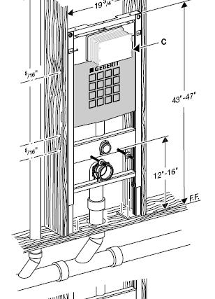

    12,419
    If you have a floor mounted rear outlet bowl, then most are going to be pressure assist.
    If you are looking for a wall mounted bowl, then you can find gravity bowls in some of the in-wall tanks, and with the Crane Rexmont wall hung toilet.
    The Crane Rexmont doesn't work very well though.
    The American Standard Glenwall pressure assist works pretty well for a wall hung toilet.
    Not really quiet, but not too bad either.
    Some of the old Kohler pressure assist bowls were quite loud.
    The newer Kohler bowls with pressure assist are much quieter then those.
    Caroma Sydney Smart back outlet, Gravity
    Here is the Gerberit in-wall system
