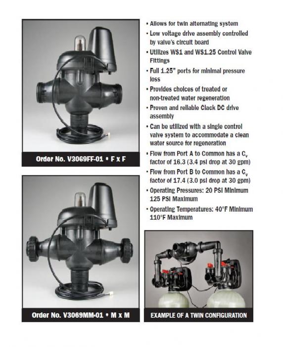

    Hi Gents,
    I would greatly appreciate yo advice here.
    I am looking to purchase a twin tank system to get a continuous flow of soft water.
    One thing I am really interested in is to set up a twin system in a way that regeneration happens at night rather then immediately, but tank swap to be immediate as soon as one tank is exhausted.
    I want this to avoid pressure drop if regeneration happens during a day. But I need a switch happens immediately to always have soft water.
    Exhausted tank must pass control to a new tank immediately but must wait till night to start regeneration.
    Kinetico twin systems regenerate immediately and cause pressure drop.
    I started looking into culligan twin units where it is possible to set up time when regeneration happens.
    However, I do not understand whether it is both swap and regeneration happens at a preset time or Exhausted tank passes control to a new tank immediately but waits for preset time to regenerate (what I want).
    culligan sale reps are confused here and tell different things.
    Please advise.
    Thank you
    / John
    Yes Kinetico and all other regular twins have a pressure loss and reduced flow rate when they regenerate a tank.
    Reading the above and the rest of your posts in the thread, I think you may want to look into a Clack Alternating twin using two regular softeners. It can delay regeneration as you want and you can get the no hard water by pass. The system has been on the market for a number of years.
    Here is a bit of information on it is done.Name:  clacktwin.jpg

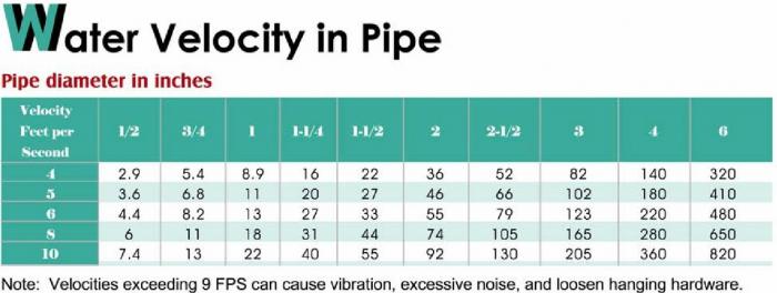

    Flow rate is based on many calculations, one of the most misunderstood by non plumbers is frictional loss. basically, the more smaller pipe you replce with larger pipe, the less overall frictional loss you will have. Even though your meter is 5/8" it has a very short length so the total loss will be minimal. I have charts I can pull up tomorrow, but they are very long, boring, and highly detailed calculations that usually do not apply unless you have excessive water flow needs at your house. Simply put, try to minimize pipe lenght, and never put in smaller pipe than what you currently have. The primary consideration for pipe is velocity in feet per second. You should never exceed 9 FPS, and preferably you should stay below 8 FPS. It will not hurt to install a larger 1" line, you will probably not notice a difference either. Hard to say without extensive details about your plumbing.
    Sediment filter... there is usually no reason to put one in. A softener acts as a sediment filter (poorly), and it is self cleaning during the backwash cycle. Do you have iron, sediment that is a real problem, or are you just wanting to install the BB filter as extra protection?
    As to the parrallel design, a single BB will give you more than you will ever need. If you have a legitimate sediment issue, I would highly recommend a backwashing system that requires almost no maintenance. A few companie offer softeners with backwashing media tanks stacked on top of thesoftener eliminating an extra control valve and it uses no more water than a standard softener system. Send me an IM if you are interested in a stacked tank design with sediment filtration incorporated, I know a few good companies that do that at a great price.
    A quick side not, check out the velocity chart, they are claiming 50 GPM for a 1" system... what would the velocity be at that flow rate? Way beyond the recommended.
