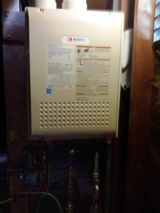

    I finally got my new NRC-1111DVNG installed. It is almost completely silent and has a Redytemp hot water recirc pump with dedicated return to supply the kitchen at the opposite end of the house. I also installed Fleck 7000 SXT Centaur carbon filter tank and water softener tank, both 1.5 cubic feet, to protect the wifes skin and the hot water heater. Gas pipe starts out at 1-1/4" from a larger meter that I had the gas company install, dropping down to 1" about 50' from the heater. It does not adapt to the 3/4" inlet pipe untill 6" from the heater. Same thing with the water in/out - 1" copper adapting down to 3/4" right at the heater. Hard pipe only with unions and isolation valves for service, no flex.
    I really like the lower temperature allowed by the tankless HWH, which does not require excessively hot water just to retain capacity. Makes it much easier to adjust the temperature at the faucets. Not to mention the Toto thermostatic shower valves.
