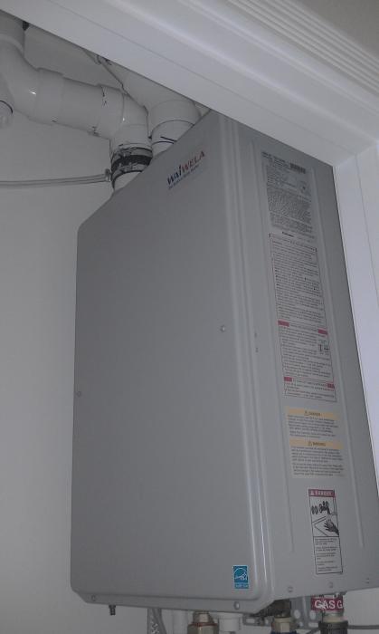

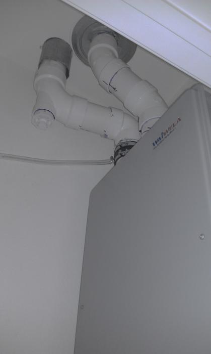

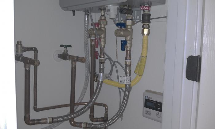

Installation Pictures
Here are a few pictures of my tankless heater in the utility closet. You can see the two 3" PVC conduits and the rubber condensate collector on the air intake.
I also added a 3" 'T' above that just in case.
By the way if you do use a concentric vent, Do not cement the rain cap to the pipe. If you do that, you wont be able to service the vent if you need to such as repairing or changing the roof flashing, or if something gets into the vent itself.
Also, remember that this unit is basically a computerized water heater. Like any sensitive, expensive piece of electronics, it should be protected by a good surge protector. I used a ups for a computer. I will also be adding a Siliphos Aquapure filter in the cold water line to help prevent scale and sediment.

I thought I would attach this gas table for reference and comments. Given that he has a 1" line in the attic, Maybe he could upsize his gas meter and inlet pressure. Using CSST really eliminates elbows and fittings. Of course the system should be grounded.
