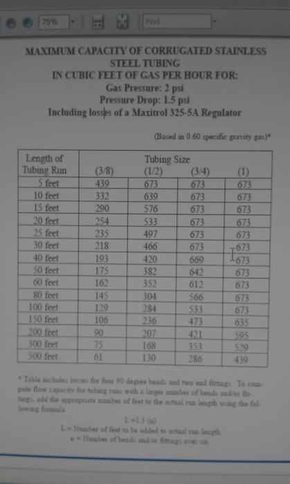

Think again about using 3/4" goods- with a 199K burner a 3/4" line would only get you 10' from the meter, with no ells or tees.
^ (the numbers in the grid are max-kbtus) ^
Almost every real-world installation needs 1-1/4" gas lines up to the unit, with a reducer for making the connection. Undersizing the gas lines introduces a whole load of operational misery, especially when the furnace fires up. Do it right the first time and save yourself the pain of having to rip it out and start over. Very-short sections of 1" or 3/4" aren't much of a problem, but I do mean VERY short, with as few turns in the skinnier pipe as possible.
