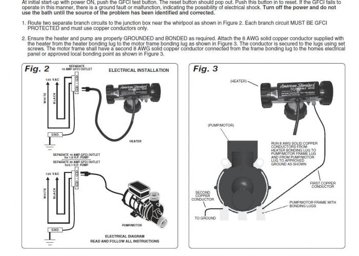

    Hey everyone,
    As part of my bath remodel I am installing a new jacuzzi tub and heater and understand that they need to be properly grounded and bonded with a 8 AWG solid copper conductor. Having pulled up the subfloor to plumb the new tub, I noticed a solid copper line running under the floor. As far as I can tell, this copper line is clamped to an outside galvinized pipe running into the ground and into the house and the copper line runs from there through the house over to the main panel. Assuming this is the grounding wire, could I connect the 8 AWG solid copper conductor from the tub motor and heater to the grounding wire and be good?
    P.S. I noticed that I don't have a bonding wire that connects to the pipes around the water heater or anywhere else as far as I can see. Is this something I need to have fixed or does the grounding wire being connected to the galvinized pipe take care of this issue?
    Thanks everyone for the help!

    Thanks for the explanation. I guess I'm a little confused by the installation directions provided with my American Standard jacuzzi tub. If you look at the image below, Step 2 says to ensure the heater and pump are GROUNDED and BONDED and that they should be connected to a local bonding point. And FIG 3 shows the 8 bonding conductor from the pump going to ground.
    I just want to make sure I'm doing the connection right.
    Thanks for the help!

    First I would like to say that I do appreciate you taking the time to try and help me out. But let me reassure you that I have been doing a lot of thinking about this installation which is why I posted my questions on this forum.
    I understand what an EGC does and that it connects to the motor and heater. What is throwing me off is the instructions requiring the bonding conductor between the heater and motor to be connected to the electrical panel or an approved local bonding point.
    If you are telling me that I don't have to connect the bonding conductor to the grounding electrode conductor I found in the floor, then were should I connect the bonding conductor from the motor? As I have said already, Fig 3 of the instructions is showing the 8 bonding conductor from the pump going to ground. From what you have wrote, it sounds like you are telling me that I don't need to have the bonding conductor from the motor connect to anything. This is what is confusing me.
    The instructions specifically say that the 8 bonding conductor from the motor needs to connect to the electrical panel or an approved local bonding point. No where does it say that the EGC of the circuit branch serving the motor will satisfy this requirement.

    The way I read the installation instructions (previous post #6), the motor frame "shall" have a 8 bonding conductor connected from the frame bonding lug to the home electrical panel or an approved local bonding point. "Shall" meaning that it is required. It does not say anywhere that this is an alternative if you don't have an EGC in your circuit branch. Also, looking at the instructions you can see that in Fig 2 they are showing an EGC in the GFCI and in Fig 3 they are showing the bonding conductor from the motor going to ground. No where in the instructions does it say it should be one or the other so one would have to assume that you need both for a proper installation.
    I'm sorry if I'm sounding dense but I just want to be sure to install this tub the way the manufacturer specifies. If everyone is telling me that there is no bonding conductor required to connect from the motor to ground or another bonding point, are we saying the installation instructions provided by American Standard are written incorrectly?

    Well you may be better served by reading what the NEC requirement has to say;
    680.74 Bonding.
    All metal piping systems and all grounded metal parts in contact with the circulating water shall be bonded together using a solid copper bonding jumper, insulated, covered, or bare, not smaller than 8 AWG. The bonding jumper shall be connected to the terminal on the circulating pump motor that is intended for this purpose. The bonding jumper shall not be required to be connected to a double insulated circulating pump motor. The 8 AWG or larger solid copper bonding jumper shall be required for equipotential bonding in the area of the hydromassage bathtub and shall not be required to be extended or attached to any remote panelboard, service equipment, or any electrode.
    As can be clearly seen there is no requirement for connecting this #8 to the grounding electrode at all except what the manufacturer is saying and saying in error in my opinion.
    As a student of electrical theory myself I will say in no terms would I connect my tub to the electrode conductor no matter what the manufacturer had to say about the matter. Any well versed electrician will tell you that every electrode conductor installed will carry some current. If what I was looking to accomplish was to keep everything in my area at the same potential I wouldn’t connect to anything which would be carrying current.
