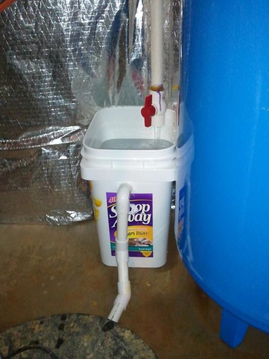

    Ok - so the dressler coupling is a BUST - literally. I do not recommend them for this type of repair. I put one on and was fortunate to be only about 20' away when it BLEW. I thought that I might not have tightened it enough or had the rubber gaskets slid far enough up the pipe, so I gave it a second try. Sure enough, it blew again. So, now I am going to plan C. I've cut the pipe on the vertical and installed a ball-valve. I am waiting 2 hours for the joint to dry and then stopping the flow (completely if all goes well). Name:  2012-03-29 11.01.53 small.jpg

    What solvent cement did you use on that joint? I've never seen any that's baby-poop brown.

    It is Oatey Flowguard Gold. Although it can be used without primer, I still used the primer which might account for the color being a bit unusual.

    That is for CPVC. It looks like you are using PVC, correct?
