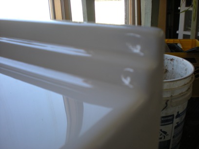

OK, so I listened to your wise voices and bought a new tub (acrylic, white, my kid loves it which is all that counts, I guess).
But it has a weird flange, NOT flat, 1/2" lip, then down to another 1/2" lip, then to tub.
SO I am wondering:
a) how to anchor it to the wall and
b) where the concrete board should go to above it (I will be tiling)
I'm going to try to post a (bad) photo here so you can see what I am talking about.
Thanks all for past and future advice.
Lelani

What is the make and model?? What do the installation instructions call for??/ Yes..we DO read the instructions!

No instructions I could find, in box or on line. Dee Bath Products, imported by Can-Cell Industries, special order for Canadian Tire.

Found instructions, seems the boys took them out of the box. Says to pin it to the wall with screws. Haven't yet but tub has some sort of support along long end and also adjustable legs, which we used to ensure it was level both ways. Will only attach along long side as my effing house is not quite square :-(
