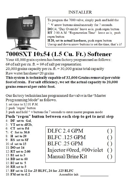

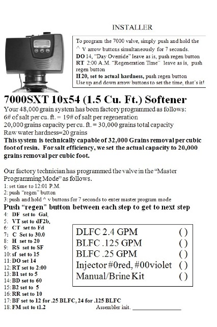

Here is a set up sheet for a 1.5 Cu. Ft system, 10x54, with 6# salt per regeneration. This is a generic set-up sheet we use during assembly, you will need to set the actual hardness, and you can probably set the SF to 10 instead of 15. Set the RR to 5 minutes instead of 10.
oops, I converted the file wrong and have a minor error, not sure how to remove the attachment below, but the top one is correct.

OK, got the hardness test kit and I am only at 7 grains hardness right now. Could go a bit higher in the summer, but I'll check periodically and program a safety factor for now.
Configuration below is where I am set right now. It will definitely regenerate too soon based on current programmed hardness being too high. Will changing the hardness be reflected immediately in more gallons of capacity remaining, or does it not recalculate until the next regeneration? Right now I'm at 1856 gallons remaining, which will take me another week to use up.
I am still unclear about my capacity being set to 44,000, which I believe was a safety factor without using the percent safety factor from 48,000 for a 1.5 cu ft system. But with a 12 minute brine draw at 0.25 gal/min, which is 3 gal or 9 pounds of salt, I thought my capacity would only be 32,000.
I think I should set H to 7, C to 32,000 and separate the capacity from the safety factor by setting SF to 15.
What do you guys think?

Re-programmed as shown below. Indeed the hours remaining did increase when the hardness was decreased. But the capacity was erroneously large and it had run for a week, so I did a manual regeneration.
One thing that I don't understand is why the brine line runs dry? It is programmed to Brine Draw for 60 minutes, yet sucks up the 3 gallons of brine in less than 15 minutes. Then it sucks air. Is this why I get air bubbles out of my faucet for days after a regen?
What determines how much brine is used, the brine fill time? So it dumps in three gallons after the regen, then next time it draws until those three gallons are consumed, then sucks air?
I have a safety float and an "air check valve" in the brine tank. Is the air check valve supposed to stop it from sucking air?

Its late and I have one of my many daughters birthday party in the morning so I will answer part of your question, and I will recommend you copy my set-up sheet above, except change the hardness to 7. I tried to modify your settings as well.
The BR cycle is called by many the brine cycle, but it real name is very specific. It is "Brine and Rinse" The "brine" portion should take approximately 15-25 minutes, or approximately 1/3 of the total time. The remaining time is the "Rinse" cycle which slowly rinses the remaining salt from the resin bed. The water still flows through the injector causing suction on the brine line. The air check inside the brine tank should prevent the system from sucking air into the softener. If you here air being sucked in, you have something in the seat of the air check or it is worn. These air checks typically last for 10-20 years. String from the salt bag, a piece of paper, etc. Anything can an airleak, if you hear one, remove the aircheck and thoroughly clean it with water and check it carefully with a flashlight.

Thanks for the info. The air check valve (actually the whole system) is brand new, so I don't understand why it would fail. The brine tube is definitely full of air after it draws all the brine out, and it does sound like it is sucking air. I rinsed it out and blew it with compressed air. Hopefully that unsticks it. I could hear the valve rattle freely.
I reprogrammed DO to 30 and C to 36,000. Can you explaine the reasoning behind the increased C? I thought 1.5 cu ft with 3 gals/9 lbs was 30,000 or 32,000 grain capacity? Right now it shows I have 4,572 gallons capacity remaining, so should go for a good 3 weeks before needing a regen, so I certainly understand the reasoning behind increasing DO. I will do it manually so as to observer the air check valve function, and replace if it does it again.
On the one hand, it seems my system is slightly over-capacity. But a smaller 1 cu ft system has a pretty low service flow rate, which I thought would be inadequate under some circumstances.

Sorry, I should do my math a little more carefully when I am tired. long day here with my daughters B-day. Your salt setting is 12 minutes, x .25 gallons per minute. = 3 gallons x 3 pounds per gallon, = 9 pounds. I am doing this quickly so please check my math. 6 pounds per cu. ft. = 20000 grains x 1.5 = 30K I was thinking 8 pounds. You are correct to set it to 30K, not 36. Thanks for the catch.
