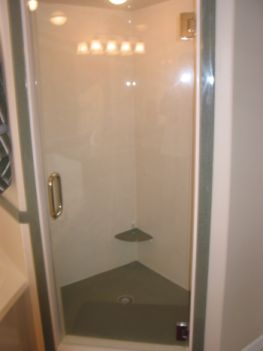

I may have misled you a little. The base is a custom cast piece. Before it it fully cured they weigh down the center where the drain goes to create a slope. The base is essentially flat except for the slight slope that has been created. The walls are butt jointed to the base and sealed with silicone. I haven't committed to this installer yet. Here are a couple of pictures of his work.

A Custom base will not bear a cUPC mark. It will need to be installed over an approved drain and liner. Flood test. Inspection.
Then installation of the topping material. if it is allowed to be installed over a liner. I bet a mud bed will be needed first.
