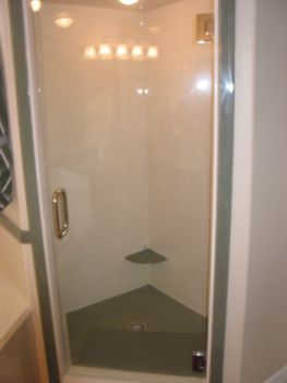

    I am having a shower installed in my basement. The shower is approx. 2.5' by 4'. I am having an cultured marble type of material installed in the shower. It is 3/4" thick on the base and 3/8" thick on the walls. The installer indicated that he wants to wait until I have the water-resistent drywall or cement board installed before he proceeds. He would then come in and install a vinyl liner directly on the cement floor (no pre-slope) and the vinyl would not be behind the wall board. He then puts down a bed of mortar and install the preformed presloped cultured marble base and glues the walls to the wallboard. Is this going to last or am I just asking for trouble?

    I may have misled you a little. The base is a custom cast piece. Before it it fully cured they weigh down the center where the drain goes to create a slope. The base is essentially flat except for the slight slope that has been created. The walls are butt jointed to the base and sealed with silicone. I haven't committed to this installer yet. Here are a couple of pictures of his work.

    A Custom base will not bear a cUPC mark. It will need to be installed over an approved drain and liner. Flood test. Inspection.
    Then installation of the topping material. if it is allowed to be installed over a liner. I bet a mud bed will be needed first.

    That's the part that concerns me. Without a waterproof seal between the base and the drain i would expect at some point in time that water will work it's way down into the mortar between the base and the liner.

    With a properly prepared clamping drain and liner you will have multiple weep hole locations. These can be improved with a Noble Weep Hole Protector, Candle Wick, Pea Gravel or what ever your tile setter prefers to prevent them from being plugged while setting a mud bed over the liner.
    This mud bed can be fine tuned to fit your base perfectly. Often the base supplier will have one or two drains that work with it. Make sure this drain makes it's way to the plumber for approval before the install boys arrive. Set the drain (allow for preslope material), install liner (40 mil most likely required in your town) and flood test.
    Once this is passed you can prepare the mud bed over the liner and then install the base. Any water making its way between the seal of the base and drain will weep through the weep holes.
    A proven system that has been working for decades when built correctly.
