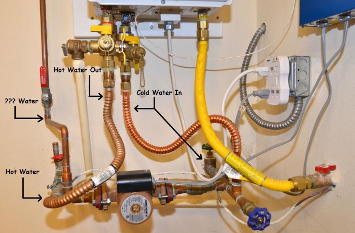

    Good debate on the degree to which temperature, flow, and mineral content all play a role in corrosion.
    I've been staring at my plumbing this weekend trying to figure out how it's set-up.
    If you look at the picture below you'll see that the cold water comes out of the wall and T's with one branch going to the inlet in the bottom of the water heater (bright flexible copper pipe) and the other branch going directly into the recirc pump.
    The water comes out of the recirc pump and goes into the wall. It doesn't appear to ever go through the heater!? What am I missing.
    Name:  plumbing with lables.jpg
    Aaron

    Are you sure that the pump is not pumping to the right in the picture? Your "??? Water" pipe would typically be the return of the recirculating loop.
  7. #22
    Plumber jimbo's Avatar
    9,001
    Look for a direction of flow arrow on the pump.

    Ewww… Good question. That would make more sense if the pump was pushing water to the right. It seems like that green valve (barely visible behind the yellow gas line in the photo) would need to be closed if that's the case.
    I'll check the pump tonight to see if it has any markings.

    Ok, so there's an arrow on the back of the pump that would indicate the pump is indeed pumping left to right. So the ??? line is in fact the hot water return.
    Now I'm curious about the green valve. I wonder if that's cold water coming in with a one-way valve.

    Looks to me your check valve is in the wrong location. It should be located just after the stop valve at the wall on the cold side. The direction of flow would be toward the heater.

    Ok, so I just took the cover off the Takagi TK-3 water heater and pushed a button that's supposed to bring up any error codes. I threw a 3-2-1 code which maps to "Inlet Thermistor Fail" Assuming the inlet and outlet thermistors work together to control temperature and decide when to power the pump, having a bad one on the inlet seems like something that could cause the water to randomly go from hot to cold.
    I've searched on the web and can't find parts for this thing. Where would I go about getting a replacement thermistor?
    As for the check valves, I'll look at that Hackney. Given that things worked well for a long time and suddenly started failing I'm guessing something has gone bad vs. things are plumbed wrong but as I said in my original post, it wouldn't surprise me if things actually are plumbed incorrectly given the sub.
    Aaron

    If I'm understanding correctly, the green valve is the supply of cold water to the heater. If you close that valve, you will have no hot water at all ! Keep in mind that the recirculating loop is important only when hot water is not being used - it keeps the water in the pipes hot for when needed. Once you start using hot water, the recirculating loop has very little effect on the system - then you need cold supply flowing through the heater to create the hot water.

    Jastori - Thanks for the clarification. That makes sense and is consistent with what I decided last night after looking at the system a bit more.
    I'm pretty convinced the error code I mentioned above about a bad inlet thermistor is the culprit. Now I just need to figure out where one gets a thermistor for a Takagi TK-3. Anyone know?

    While a thermistor might fail, they're pretty robust SS devices...it might be the control board. Often, there's an easy test for a thermistor if you have a multimeter...the resistance at a specific temperature can easily be read. A pot with some water in it and maybe some ice, and you can check that it changes over temperature changes according to the spec sheet (which might be in the manual).
    As said earlier, some tankless systems/models void the warranty if you add recirculation, or don't do it per the instructions. Regardless, it does stress the thing more than without, at least in a typical home. Another reason why a commercial installation and residential tend to have different length warranties.
