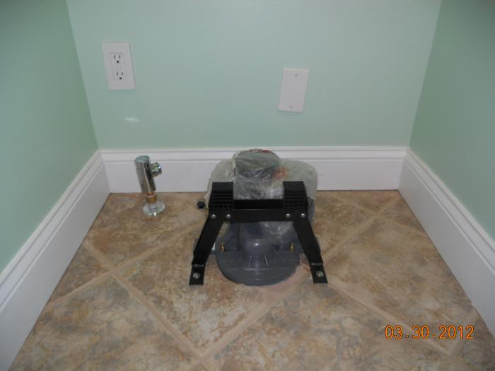

    DIY Junior Member agie's Avatar
    Mar 2012
    SE CT
    Rough in for Inax Regio. Had to move water supply to the left, 11" required due to stiff hose. New dedicated electrical circuit, requires only 700w.

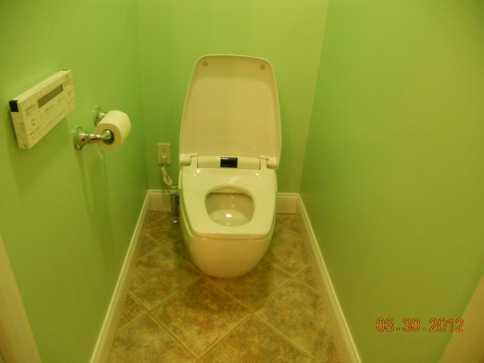

    Mar 2012
    SE CT
    Complete install, Inax Regio. Using for couple days, hot water wash love it. Even partial fush is strong enough for solid waste, very quite flush.
    Yakima WA
    6,844
    Looks good. Hope it continues to work well for you. Did you ask about availability of replacement parts? Eventually all toilets require a bit of TIC, and it would be a PITA to learn you had to get parts from the factory in Japan and/or pay a king's ransom for them.

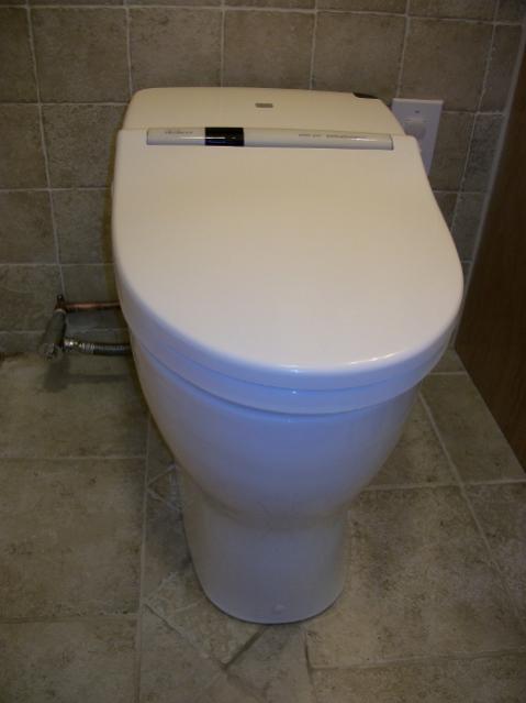

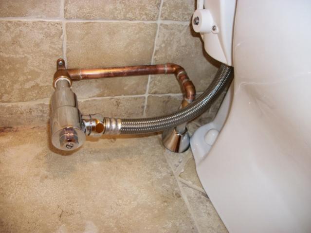

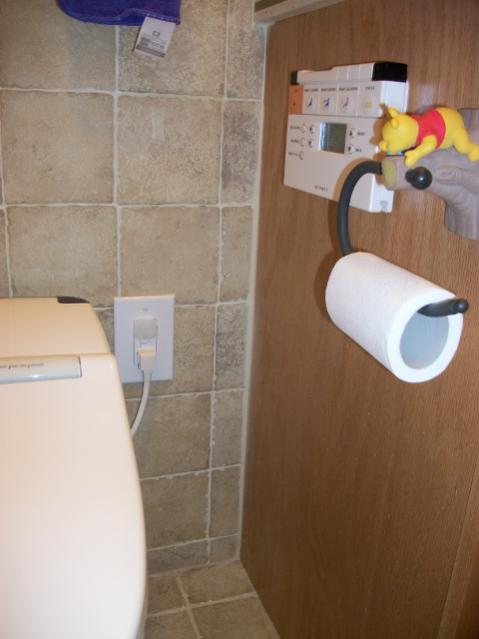

    Cool Neorest 500 install
    Name:  100_1334 (480x640).jpg
Size:  29.2 KBName:  100_1335 (640x480).jpg
Size:  34.8 KBName:  100_1336 (480x640).jpg
Size:  24.3 KBAnd here is Neorest 500, needed one compact size, Neorest 500 fits well, just installed it over the weekend. Dedicated 20amp GFCI circuit, moved the supply line as shown (idea came from previous post in this forum). Working well. Notice main supply is 1/2" pex, converted to copper to install ear drop for valve. First difference noticed is seat warmer, not as quick as Inax, toto claims it takes 15 minute for seat to warm up. Like the warm wash, Neorest has instantaneous warming compare to Inax Regio (uses tank heater) so no worry to run out of hot water. Still need to learn and use other features. will post in couple weeks difference between the two.
