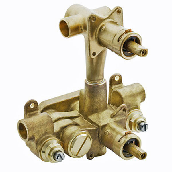

    I have the moen 3330 valve and the plaster plate was not set flush with my marble shower surround. My problem is the installers of marble surround threw away my plaster plate and I have no sure way of knowing the correct placement of valve. I need to know if someone can give some help. I have called moen and they are unable to give me any help. I tried to order face plate but they told me it would at least two weeks before they had any and I really need to get valve set before then if possible. I would appreciate it if someone could give some dimensions or other suggestions.

    There is some allowance in the valve. I would try installing your trim and see if it works as is.
    Parts breakdown
    This picture says thin wall but it gives you an idea of what is projecting from the finish wall too.
    The upper diverter
    9,004
    One way would be to install all the trim. Then if you know the composition of the finished wall..., e.g. 1/2 cement board, 1/4" tile, 1/16" mortar...that will take you back to the plane the valve should be mounted at. The plaster ground probably allows 5/8" wiggle room, but we do hear complaints from people if the valve is mounted too far out...they say the handles look funny. Too far IN, the handles will stick
    23,716
    I think you have confused me. IF the marble is already set, then the valve's position should be fixed, and all you have to do is install the trim pieces. In fact, at this point, that may be ALL you can do. If the plaster ground was not flush with the marble, then it could be too shallow or too deep for your trim. If it is too shallow, you are out of luck, if it is too deep, you can get a 1" extension kit.

    sorry I confused you. i have access from closet. If I had my plaster plate I could unsolder the valve and reposition the valve. my problem is that the company installing marble threw the plaster plate away. I didn't realize until it was too late. I thought maybe some one may be able to give advise on how to reposition the valve without the plaster plate.

    Even with the plaster guard, it might not be where you want it. The distance the knobs stick out is much a matter of aesthetics and everyone has a different opinion as to how much is too much.
    If you REALLY want the plaster guard, go buy another valve and then return it when you are done.

    I am working on a job where another company installed the Moen valves then tossed the plaster guards. At that point they were useless anyway, except to make sure the tile company made the holes large enough. When I got there, it looked like they were installed too deep, so I tried the trim on the valves to see if they would fit. Most of them did, but one is marginal so I won't know if I will need an extension until the tile is finished. Install the trim and see if there is a problem.

    Unless you have a thinwall installation, once the valve's position is set, there's no reason to keep the plaster guard.
    As already said...if the trim will fit and tighten up, it should be okay (but you may not like the way it looks). If it sits too far into the wall, then you either need to move it forward or buy the extension kit (if one is available for that valve).

    The trim plate is the chrome ring. If he threw it away he needs to get you a new one because it is part of the valve and you cannot finish it without the ring. You say you "tried installing the trim". What happened then? Did it, or did it not, fit. If not then I hope it is too deep in the wall so the installer can GIVE you the necessary extensions. If it is too shallow then the valve has to be moved. So far you have NOT told us anything about how the trim fits or if you have it all, so we cannot tell you what, if anything, you have to do.
