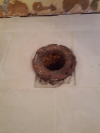

    Things can never go easily... I determined the toilet is actually a 17.5" and was going to set it with a taller seat. I now discover that my toilet flange is too high - close to an inch off the floor.
    Is the easiest fix to drill out the lead, remove the flange, cut down the pipe and install a Twist-N-Set PVC flange? What is the easiest way to cut down the pipe? I don't have an angle grinder, but do have a sawzall.

    So I think you are telling me I don't have enough vertical drop for the twist and set connector to seal before hitting the bend? That makes sense.
    I don't I have easy access to that bend. It is right near a main support beam and some built-in bookcases in the basement. Going all the way back to the stack, or cutting the horizontal pipe and mating PVC, might be easier to access. Can't quite picture it now since I'm not there.
    Is there any way to attach a new flange after lowering the pipe a bit? I did pick up an angle grinder at lunch thinking I would have to cut something, plus I have had the need for one in the past.
    Here is a rather blurry picture of what I am dealing with.

    Another wacky (or not) idea. What about just using the existing tile as a riser? I'm using 12x18 7/16" thick full body porcelain. One layer would be enough to level things out I think.
    12,445
    Lead is soft and it cracks. It doesn't play well with expanding fittings or compressing fittings.
    For that reason, if they need extending, shortening, moving, replacing; we just pull them out and start over. I've seen people run a snake through a bowl, (closet auger) and punched holes through the lead.
    If you need a spacer under the flange you have, you can build the floor up underneath it.

    I realize the photo is blurry, but that flange looks to be in pretty bad shape. I doubt it will last another 20 or 30 years. It will never be easier to replace it that now.

    The flange is rusty on the surface, but structurally seems OK. No breaks or thin sections.
    I would typically agree that now is the time to replace it, but mom is due to be released from post-hospital nursing care next week, so getting this bathroom functional is priority #1. I'm going to see if a single tile thickeness will level things out. If so, I will trim it when I finish up the shower this weekend and mount the toilet that way. If something does not work, it is not a big issue to pull back up and should still look better than a plastic riser or trim plate.

    The tile is the perfect thickness to bring the floor up to the proper level. Since I'm renting a tile saw again anyway, I'll jut cut one to match the footprint of the toilet. Probably not the best solution, but the one that fits my time and budget at the moment.
    Is silicone the best solution to join tile>tile>toilet?

    You have a cast iron bend, not a lead one. A plumber would "knock" the old flange off and install a new one in a matter of a half hour or so.
