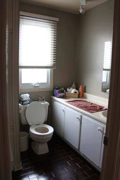

i'm about to remodel my master bathroom and will be re-doing plumbing. The layout will be the following:
Shower, sink, WC and bathtub.

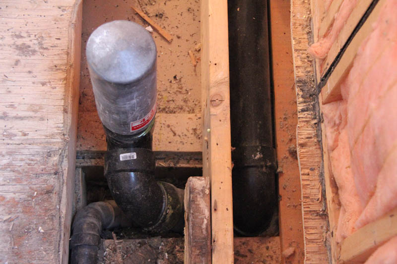

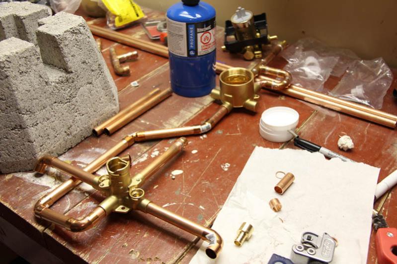

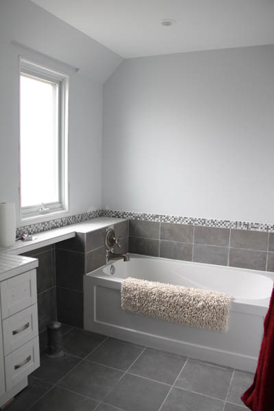

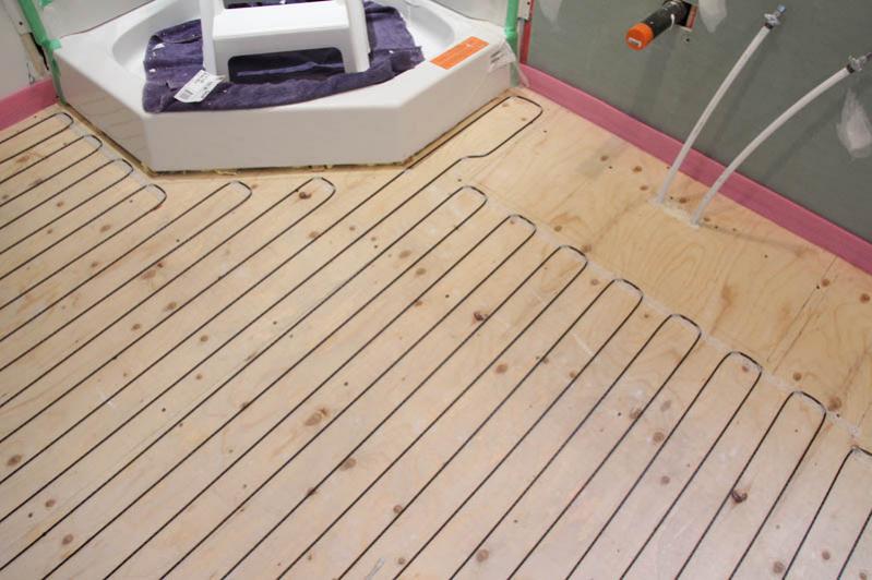

Hi everybody and thanks for the help (that i got 9 months ago). I though i'd drop by and post a few pics of that bathroom remodel project i started and completed in april 2012. It's not perfect but given i'm a computer guy... i'm happy with the outcome.
The beast
First plumbing project ever.... used lot of copper.
How the the WC draining end up.
