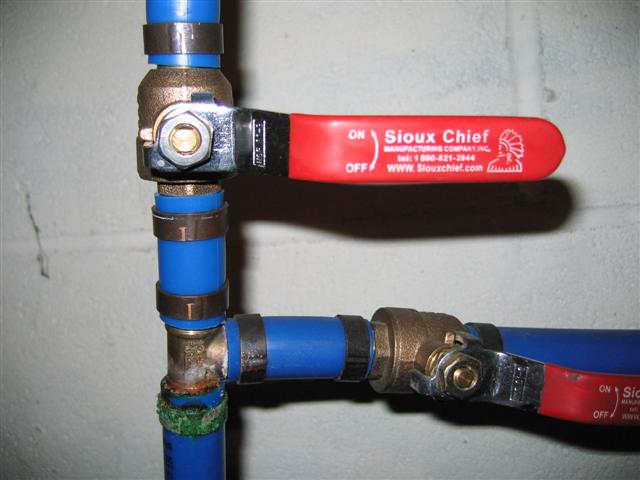

    Hmmm. I need some education. What is WROT? IIRC bronze is tin and copper, and brass is zinc and copper. Did you mean to say brass rather than bronze valves? I believe my current well settings are 40 and 60 psi for the cut-in and cut-out pressures. Below are photos of my valves. They're a little redder than I think of brass as being, which usually looks more yellow to me. Are these bronze valves?

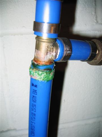

    In the photo below, there's corrosion of the fitting carrying unconditioned water coming from the well, but not after that. Is that normal to see that corrosion? Is that something that needs to be fixed?

    Without taking a fitting apart I can't give you a definitive answer but the corrosion will be caused by a couple of things. Either the fittings are bad ( the metal composition was not correct in manufacturing ) or the installers crimping tool was not adjusted properly. But, if you look at the last photo you will see a white powdery substance that runs from the fitting joint to about half way up the tee and that there is a classic sign of dezincification so you defiantly at the very least want to have someone knowlegable come out and take that apart and see what the issue is. The valves are Souix Chief and they are fine.

    I would cut that fitting out ASAP and replace it.
