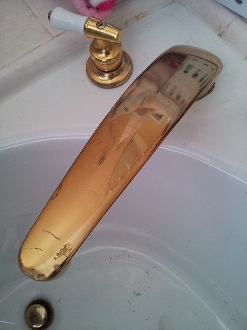

Size:  14.5 KBI'm hoping someone can help me out with this.
    I just purchased a house and the roman faucet installed in the master has two markings on it. On is SA (with a circle around the SA) and the other is UFC.
    It appears all of the other faucets in the house (bath sinks and showers) are made by Delta, and the bath faucets seem to match, so that would be my guess.
    If it is Delta, will the new trim kits fit on it? I'm pretty sure the faucet is original and the house was build in '91.
    Thanks in advance!

    I dont remember delta making a spout like that. I cant see the end of the stem where the handle fits on very well. Take a close up of the stem and the underside of the handle where the stem fits. May as well throw in a side view of the spout.
    I'm kinda thinking its a Delta knock off.
    The handles,stems,seats&springs will interchange but nothing else will interchange between a 1991 Delta roman tub valve and current Delta roman tub trim.
    9,003
    I don't think any delta handles attached with a screw down the middle...they had a set screw on the side. We do need to see the whole stem
    The old ones had the screw in the middle. The new style have the set screw.
