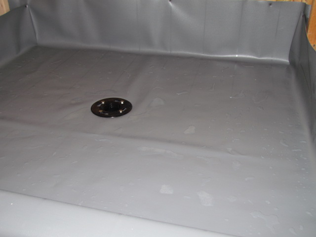

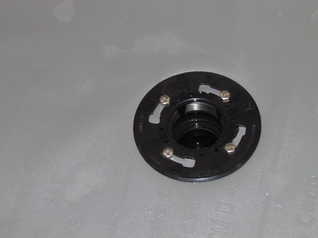

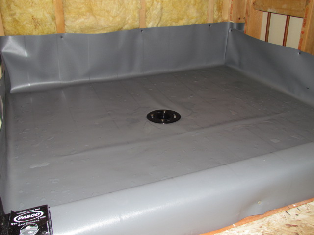

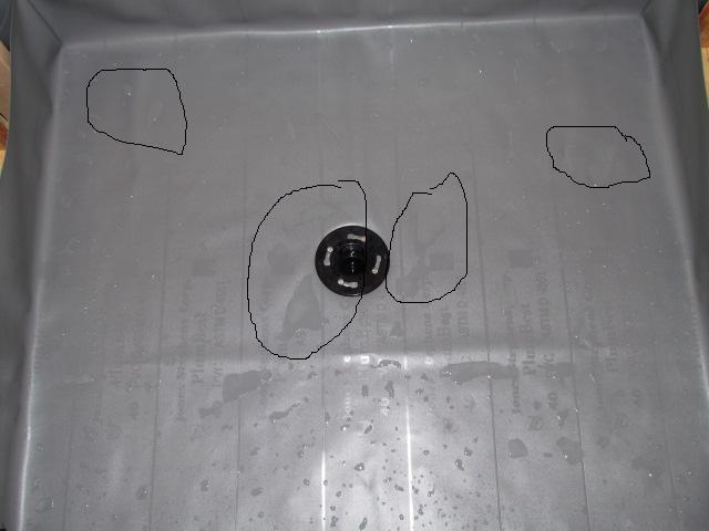

    DIY Junior Member Andy P's Avatar
    Mar 2012
    Hilliard, Ohio
    Here are some pictures of my liner after performing the water leak test (passed this time, the balloon must not have made a complete seal first time allowing a little water to drain). Is this much water too much water to have on the liner after this test. Should the liner be completely void of water after draining from the leak test? If I need to build it up a little, I've read to use a "modified thinset". What is the difference between thinset and modified thinset? Thanks for all the help.

    Jul 2009
    North Vancouver, BC
    1,579
    Great pictures.
    Nice work in the corners with that liner!
    I would not sweat that little bit of water you show there at all. The weight of the mortar will flatten out your liner somewhat and the water will wick through the drypack base to some degree.
    A little candle wick in those 4 weep holes or a positive weep protector from Noble Company is a good idea.
    I think Noble ships all order's in the states for $5.00 from there online store. A little weep hole protector like this will fit any clamping drain and is worth the effort if you do not like the idea of using pea gravel or candle wick.
    You can use Pea gravel, Tile Shims, Coffee filters - anything to keep the drypack from sealing off those weep holes.
    I tried using a little left over Ditra Drain on my last shower and that worked great. But you don't want to buy a $500 roll for 1 square foot.
    Make sure this areas don't get filled with drypack.
