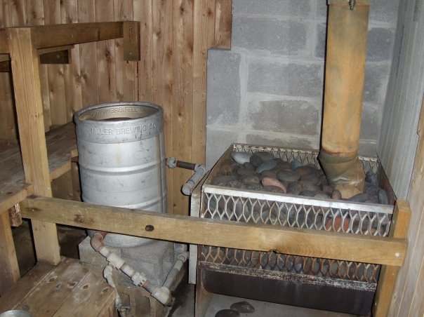

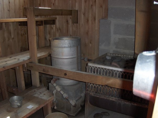

    This was in a sauna in the Upper Peninsula of Michigan where we stayed a few years back. it was a loop system. Fire box in front to heat the loop, old keg with the top cut off. fill with cold water, cold water flows thru loop and comes out hot. Same type of system i would think. Was able to dip hot water out of keg and soak your feet or add some cold water and bathe with it.
