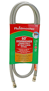

    One more question, I installed a dishwasher this weekend and used one of the floodsafe stainless steel supply lines. I read on here that they can break so I was looking for an alternate. The only one I found was a GE universal braided supply line but it does not appear to be metal.
    Is there a particular brand that is recommended?

    Fluidmaster and several other companies make a stainless steel icemaker supply line that is NOT "floodsafe".
    hj - I didn't have any luck at Lowes or HD for a 6 foot dishwasher supply line. It was either Floodsafe or the GE one that did not seem to be stainless steel (it also did not have rubber washers - just a flaired brass (?) tube inside - perhaps I'll search online. Thanks for the Fluidmaster sugguestion - I have had good luck with them.

    The easiest connection for the DIY is a braided stainless supply.
    I have also seen supplies for 3/8" that don't have washers, and they work fine.
    I always let my DIY customers know that PTFE (Teflon Tape) is not used for the braided supply lines.
