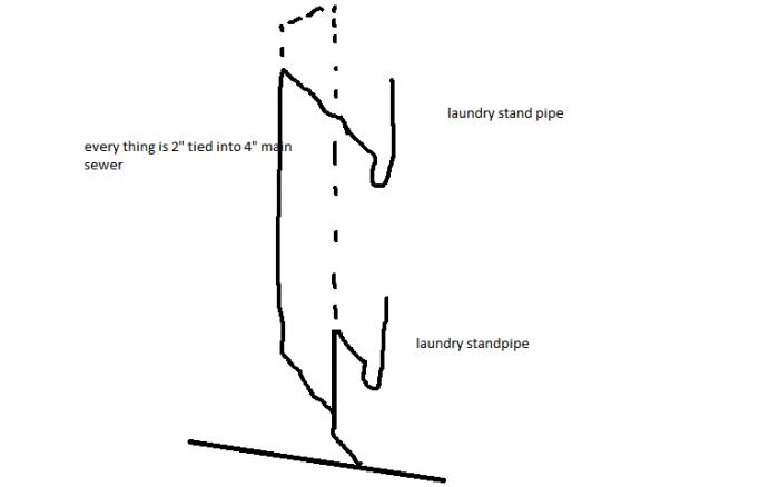

    Default Laundry Drain top and main floor tied in together?
    Please tell me i can do this
    Jan 2008
    2,674
    Not if you intend to adhere to any legitimate plumbing code.
    The lower trap would be required to have a dry vent.
    23,518
    Only if you live in Philadelphia and have an engineer certify it.

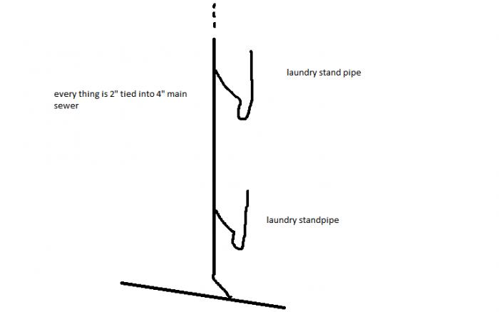

    Default So is this the proper way?
    dont mind the sloppy drawing
    23,518
    yes it is. (I need to flesh the answer out because it will not post just the word "yes").
