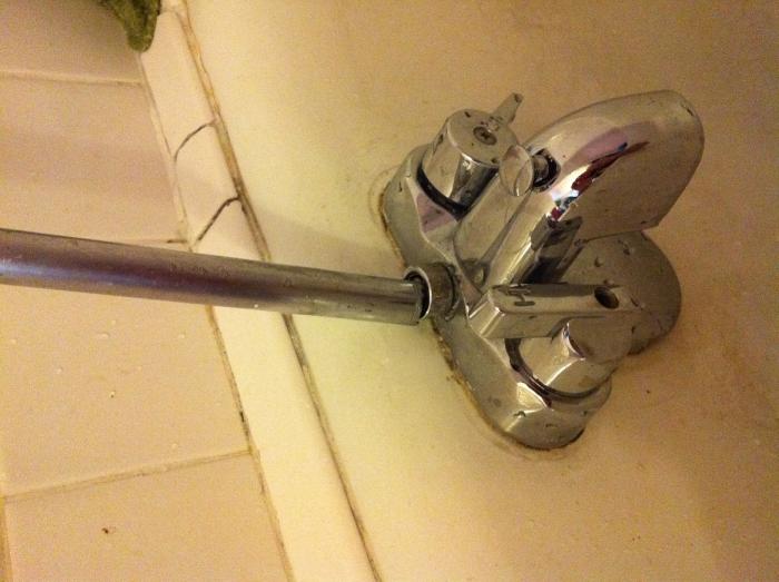

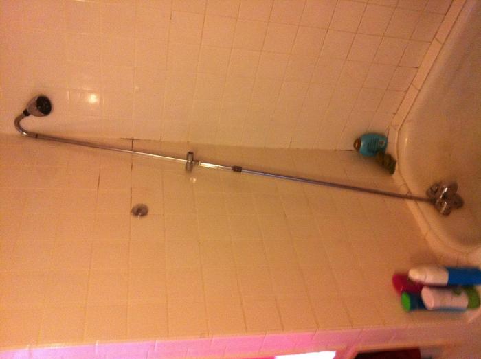

Hey There, thanks for taking a peek at my post. My long pipe shower setup recently broke from the top of the tub faucet. The threads snapped off the shaft and are still stuck in the fitting that is on top of the tub faucet. I have come up dry after spending a couple of hours on the internet. I simply have no clue what kind of shower setup I have. I joined this forum hoping that someone can point me in the right direction as far as getting parts. I have included pictures to help with the deciphering of my mystery shower. There is no brand/name stamped or etched anywhere on the unit. Your help is greatly appreciated. Thanks again for reading in.

I don't know what brand it is but that's a faucet for a Claw Foot tub. You should be able to stop in a local plumbing supplier with pictures and they will order you a faucet kit.

It is not for a clawfoot tub...it is just an old 4" tub/shower valve. They are still available, possibly from Phoenix. Code does not allow the faucet to be mountdd down there now, but whose checking???

IT is a 3 3/4" leg tub "retro shower" faucet. The riser is 3/8" chrome pipe. You have to remove the broken piece somehow, then buy a new piece of pipe the same length as the old one, probably 24" long and connect it between the faucet and the upper piece. That faucet could have been made by Chicago Specialty, but there were, and are, several other companies who make the same thing. I had one of those in my warehouse for decades before I finally decided to scrap it.

Thanks for all the info guys. I shouldnt have any problems getting what i need now that i know what im dealing with. Hardest part will be getting the top fitting off the tub faucet. In the middle of the round fitting is a piece asking for an allen key. Hopefully that will turn for me. Thanks again.
I think this is the actual faucet. I will have to measure dimensions to be sure. Now all i need to do is find a connecting pipe.
http://www.chicagofaucetshoppe.com/Spring_House_R3100B_p/spri-r3100b.htm

Three things relevent to this particular installation.
1. He DOES have an overflow in the tub, and
2. Backflow would only occur if the faucet was filling the tub, the water was above the overflow and the faucet was underwaterm adn the water supply was turned off and a lower faucet was opened to create a suction.
3. If the faucet had to be replaced there are "legal" faucets which could be used. They have a "gooseneck" spout to raise the outlet above the tub's rim.

I did manage to get the top fitting piece off(used and allen key) of the faucet. Anyone know of where I can source that part out alone without buying the entire faucet setup??
