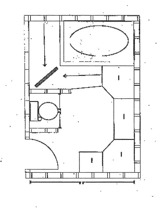

    I'm a little unsure if this should be in a plumbing forum or a tiling forum, but here goes...
    I'm totally gutting my Master Bath. I have attached a proposed redesign. The area between the toilet and the tub is the shower. I wanted a step into the tub, so I incorporated the step into the shower. In the drawing, the whole "L" shaped area between the tub and toilet is approx. 6" high. The wall between the shower and toilet is approx. 5' high. The long arrows on the shower/step are my proposed slope for drainage to a linear drain.
    Question: Should I "frame" the shower/step with the slope I need for this area to drain as designed? Or is there another way I should achieve this?
    Or, ...is this the most ridiculous thing you have ever seen?Name:  Bathroom.jpg

    Looks like a nice big space.
    I'm not sure I would install the drain on the 45 like that but it could work out with the right tile layout.
    What is your big wish list? Is there a natural grade to your bathroom?
    What type of tile?
    The step up look does open the doors to lots of options. If your framing with common lumber remember that you will still need to add waterproofing and grade into the calculations. Most lumber and plywood floors require you to add a good 1 3/8" of mortar.
    Planning this step well could free up a lot of time if the floor was designed to accept Concrete Board or Green EBoard and then waterproofing.

    That looks like a pretty good design there. I think that if you go with a linear drain on an angle like that, you'd probably need a custom sized drain to extend closer to the corners. John will have alot of good ideas in is houzz albums for you!

    Doesn't look practical to me. I would put the tub where the shower is and make it a left hand drain. Then the shower would be where the tub is with a door.

    I'd swap the toilet and the door. Then get rid of the one cabinet for clearance into the toilet area.

    I can't really move the tub because there are windows on both of the walls above the tub.

    Moving the door is not an option to that area, but I like the idea.

    What is your big wish list? Is there a natural grade to your bathroom? No natural grade, just need to create one.What type of tile? Tile hasn't been chosen yet. Is there something specific I should look for, i.e. size, color, material?
    The step up look does open the doors to lots of options. What specific options do you have in mind? I'm waaaaay open for suggestions.If your framing with common lumber remember that you will still need to add waterproofing and grade into the calculations. Most lumber and plywood floors require you to add a good 1 3/8" of mortar. I planned to frame the 6" step-up with the grade flowing towards the drain and in towards the tub, on the long side of the tub. My big question about the mortar bed is: How do I do a mortar bed in the open part of the step? Or are you saying that if I slope the framing of the floor, I won't need a mortar bed? Just concrete board and waterproofing.Planning this step well could free up a lot of time if the floor was designed to accept Concrete Board or Green EBoard and then waterproofing.
    JW
    The diagrahm I posted is kind of crappy. I'll see if I can find a better one.

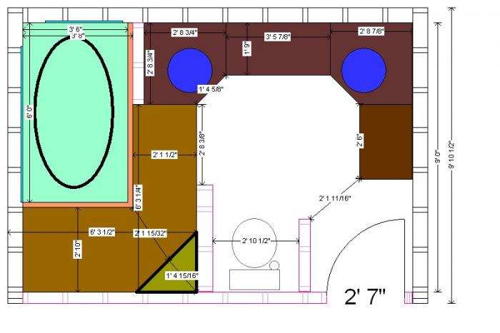

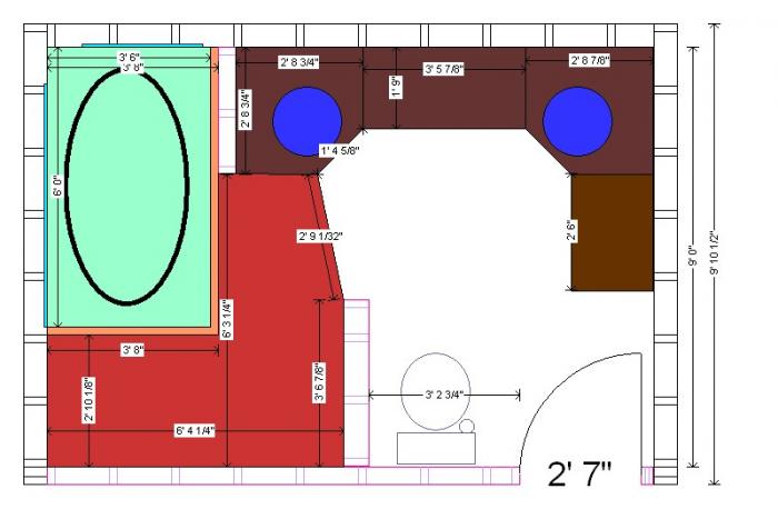

    Here is a much better picture with measurements. Lets see if opinions change. The wall next to the toilet is about 5 feet high. The shower head will be on the opposite wall. The shower is open to the tub(no glass).
    Thanks,
    Greg

    9,003
    The drainage and vent piping will be quite challenging since you have 3 "wet" walls!~

    The tub is in its existing location, so that plumbing is done. The vanity is a similiar situation with a few small mods. The toilet is being moved from where the end cabinet is next to the door. The shower is totally new plumbing.

    I did look at the link you posted. A lot of great designs. My main problem with the whole thing is that monsterousity of a tub that the wife won't part with. Even if she did, I'm not sure what I would do with that corner with the windows being there.
