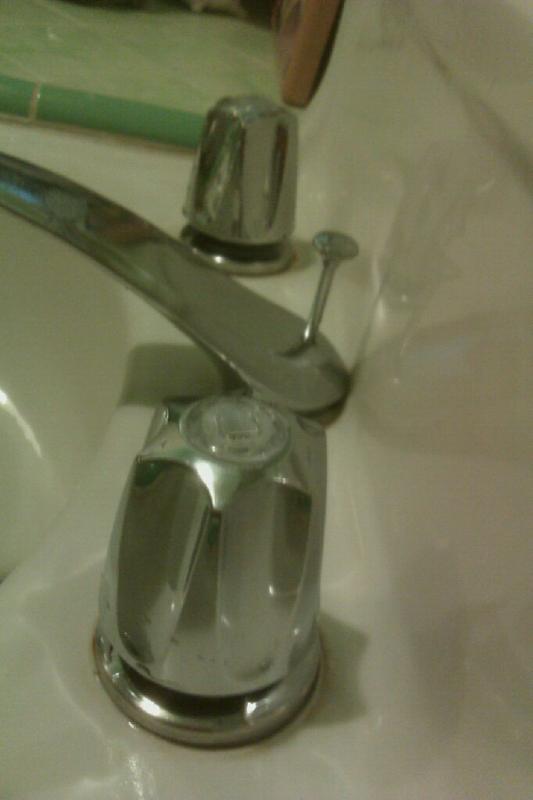

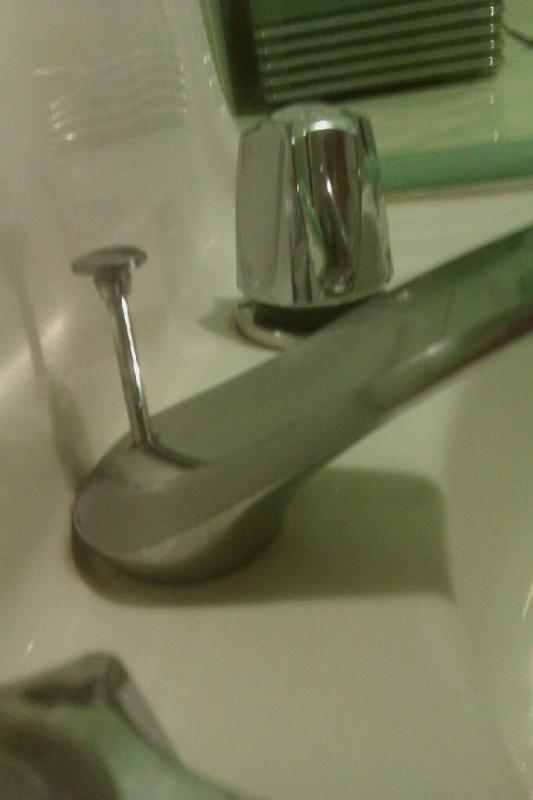

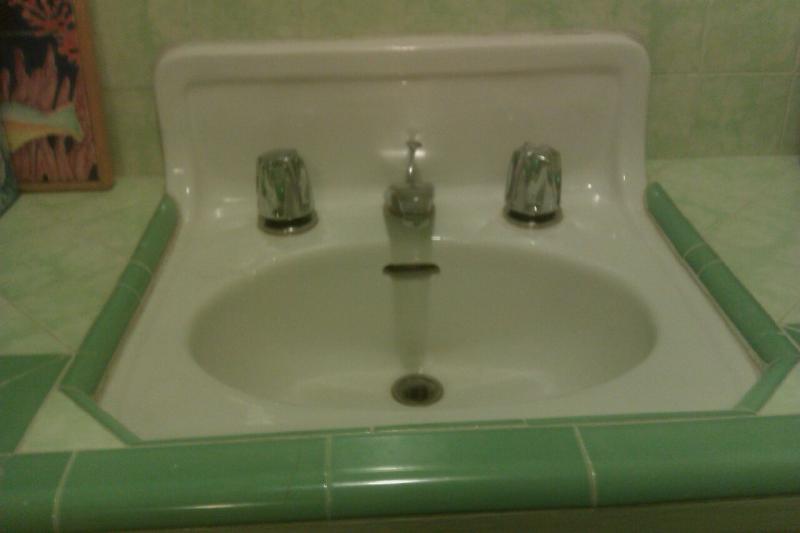

    I realize this is an old thread but this is very closely related to a problem I have. My sink is a late 40s (1949, I think) and it had the same style of 70s faucet installed by a prior owner, only with lovely clear plastic (crystal) handles. The valves are shot and resist any attempts at repair. My sink is slightly different in that it has a backsplash with a significant radius just behind the faucet. I ordered this very faucet set and found that it protrudes too far to the rear and won't seat flat due to the radius on the backsplash. Upon closer examination, it appears the existing faucet was ground down to fit...nice workmanship (not). Love the cross type handles and look of this model but just doesn't fit.
    Is anyone aware of a similar looking faucet with a smaller (or more forward set) footprint? Or any 40s style with an undercut in the back? I'd even be happy with no stopper pull as we never use the stopper anyway. Any ideas would be most appreciated!

    we would need a picture of the sink, because your difficulty is NOT normal for any sink of this type.

    Thank you for responding. Here are some photos:

    As you can see, the faucet hole is set fairly far back and behind the valves.
  8. #23
    23,547
    That particular faucet is a PricePfister wide spread, but you said it had "clear crystal handles". If this is the faucet you were referring to in the original posting, the valves a NOT 'shot' and are easy to repair to"like new" condition.
    The faucet "hole" should be the same distance as the other two, because that is the way they made sinks back then. At that time the faucets did NOT have "hoses" so all three openings HAD to be exactly in a line. But even if it is offset because of the drain overflow, your "problem" is that the spout has "overhang" at the rear. Not many new faucets use that design so you have the choice of many new ones, including all current Pfister faucets.
