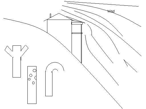

    As I write this the wind is blowing 30 to 35 mph with gusts to 57 mph. This is not uncommon here in the Cascades. Every time we get strong wind it lowers the water level in all of the toilet bowls.
    The other day I smelled sewer gas and went exploring, to find that the toilet bowl in the basement had lost its seal. This toilet is out of the way and doesn't get used much. So there may be 2 things going on, the lowering of the level and then evaporation of the small amount of water remaining.
    The house is new construction, great experienced plumber did the waste system. Three vent stacks, all on the lee side of the roof from the prevailing winds. The house has a conventional septic system.
    My biggest fear is being away for a week or two and having sewer gas fill the house.
    So what can I do to reduce the effect?
    My guess is there is a venturi effect on the vent stacks which creates a negative pressure and pull down the water level. I guess there could also be a positive pressure wave that creates a rocking effect in the bowls. It also might be both effects working together.
    I assume its happening with all the traps, but the floor drains have trap primers, so if there is activity they refill. Maybe it only is happening with toilet bowls because of their design
    Will putting a trap upside down on the top help?
    How about drilling holes in the stack above the roof.
    Would adding a double wye to the top of the stack help?
    How about extending the stack above the highest point of the roof?
    Thanks, Elliott

    Sounds like a form of venturi. Caps might fix it if it is just venturi (an effect of the opening itself), but I suspect the issue might be because the vents are on the lee side. The roof or any obstruction acts like an airfoil, reducing the local pressure on the back side. Meanwhile on the face of the house you have slightly elevated pressure that would add to the problem as you surmised. I'm not sure how plumbers account for this in normal layout of the vent stack. Extending the vent stack(s) some greater distance above the roof might solve the problem (and wouldn't be too hard to experiment with before settling on a final configuration.)

    I'm leaning strongly to venturi but not sure if it is mostly on the stack outlet or the whole roof. If it is mostly venturi on the pipe, than drilling some air inlet holes below the opening should break the negative pressure.
    I am inclined to think that the roof itself is acting as a very good wing, compressing the rushing air as it reaches the peak, which would create negative pressure (lift) on the lee side. The only bug in that theory is that the center portion of the house is round. That roof has a cone shape and that stack is in the shadow of the cone but its not a very good airfoil.
    If the whole roof is creating a negative pressure then I doubt caps would have much effect. Makes me wonder if I can run a relief tube from each stack to the peak and then into the positive air.

    Most homes do not have a main house trap...only the individual traps at the fixtures. You can't really suction a toilet trap dry easily, but you can rock the water back and forth, which will let some spill over the weir. Climbing up on a roof can be a pain and dangerous, but you could take a coupling and a section of pipe and set it on the existing pipe to extend it some to see if that would work. As long as you don't glue it, you can remove it later if it doesn't do anything. A couple of 90's hooked together to point it down might help, too as well as an air cap.
    That's exactly what I was envisioning. Bring pipe and some caps as well. Test a cap on one or two with and/or without the extension to figure out what works and what doesn't.
