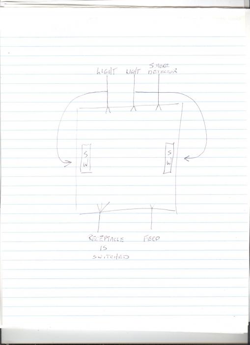

    Hi I am new here.I have a gang box which i changed from shallow to deep.I andded another wire for a light.A friend did a drawing for me but it did not work.Can someone help me the wireing??

    So are there three switches or just two?
    And if two what do you want switched together? There are three items switched.

    Thanks 4 replying -There r 2 switches..left side laundry room light..right side mud room light that also switches on the btm of the plugs in that room..smoke alarm on at all times.. i hope that helps if not ask me more please cause i do need help

    All the white wires will go under a wire nut.
    The black from the supplying circuit, the black from the smoke alarm and two pig tails that will land on each switch under a wire nut.
    The black wire from the mud room light and the black from the receptacle will go under a wire nut with a pig tail that will hit the other screw on one of the switches.
    The remaining black wire on the last switch.
    Not sure how the top half of the receptacle is being supplied as you don’t show that conductor if it is in the same cable as the switch leg going to the receptacle it will go under the same wire nut with the supply
    23,712
    If that is his drawing, it is completely useless, but the actual wiring is so rudimentary, that if you cannot figure it out, maybe you should not be doing the job.
