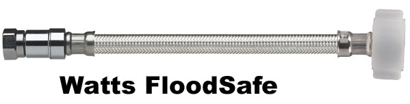

What type of supply tube are you using?
The Watts Floodsafe will prevent a tank from filling like that.
If you have a Watts Floodsafe, remove it.

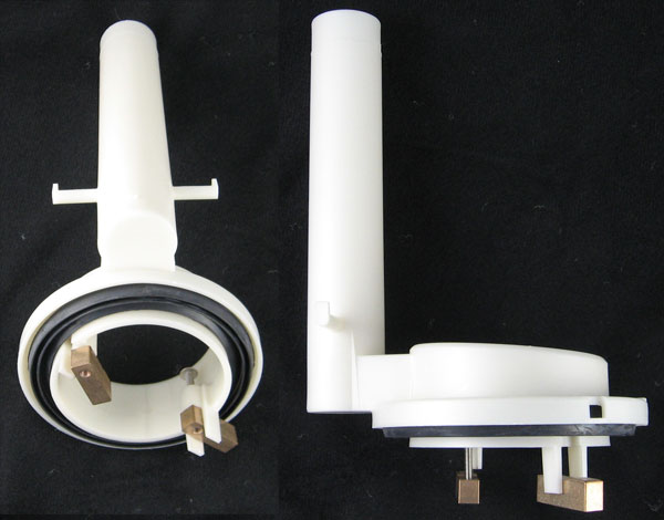

If the water is shut off to the tank, and the tank empties, then it would be a flapper or flush valve seal issue.
That would be resolved with either the flapper or making sure the seal under the flush valve is making full contact with the inside of the tank.
The flush valve removes with two screws. You can check the smoothness of the porcelain with a little sand paper, and then reassemble.
