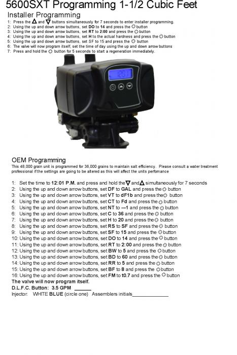

    Hello,
    Been busy and about ready to turn on the new water lines. I got the 48K 5600xt softener and would like opinions on settings as follows.
    capacity - 27.3
    hardness - 22 (I added 1 because of the minimal amount of iron) good or bad??
    Safety Factor - 10% (not sure)
    Day override - 10
    Brine Fill - 8
    Or would I be better off just going with 30 capacity with 9 BF?
    Thanks

    I can post a programming guide for that exact unit tomorrow. I return to California in the morning so I will be at the office then. My programming guide will walk you through exactly how to set up the unit.

  4. #19
    Jan 2012
    1,079
    Name:  5600sxtsmall 15 cu ft.jpg
    Quote Originally Posted by Kadex View Post
    Appreciate that ditto, will take any help that's available.
    This should help. It is self explanatory. It is what we send our controls out with so the builders can easily program them. If the water has excessive sediment, the backwash time should be increased. Otherwise, this is the industry standard programming for the majority of water supplies.

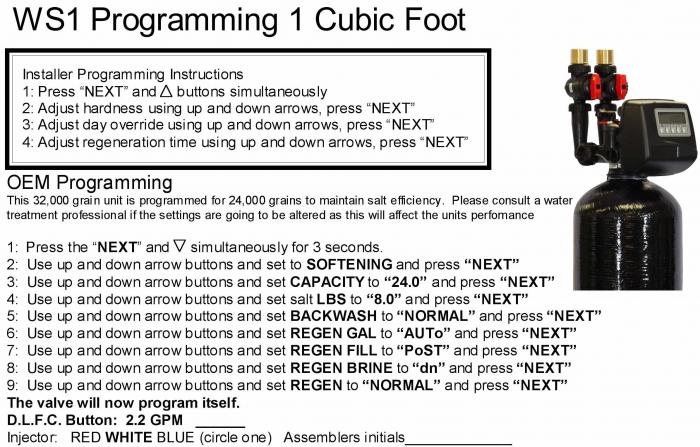

    Check out my program, please? New installation
    2 people (about 100 gal. per day total)
    32,000 Clack WS-1
    hardness--16 gpg
    using Potassium Salt
    I reset to 30,000 capacity since I read potassium is less efficient....the unit is regenerating about every 16 days...The number of gallons I'm getting betw regens is about 1830......Could/should I do better?

    Jan 2012
    1,079
    Name:  WS1 1cuft resin low res.jpg
    Your 32,000 grain softener, 1 Cu. Ft. of resin should not be run at 30,000 grains, this will waste a large amount of salt. Use the programming guide. This will give you a good balance of salt and water efficiency, while maintaining high quality soft water.
    Adjust the programming above to fill first. Potassium chloride tends to bridge in the salt tank due to its higher variance in solubility at varying temperatures. Sodium Chloride will vary approximately 1% for every ten degrees of temperature change, potasium Chloride will vary approximately 10% for every ten degrees. In a location where the temperature varies more than 10 degrees between regenerations, caking is a common problem with potasium. A garage in Phoenix can change from 60 degrees at night to 120 degrees during the day. The extra potassium is absorbed into the water, then as the temperature drops, the potassium comes out of soultion and precipitates into a cake. Here is a link to great article written in 2005 addressing this issue.
    http://www.watertechonline.com/water...ssium-chloride
    Hope this helps, and your Clack WS-1 system will serve you well for many years without fail, congratulations on buying a great unit!

    Thanks for your response, dit, but I have a question about it. First, I forgot to mention in my OP that the salt is set at 9.5 lbs. You wrote that by setting my capacity from 32K, which is what it's rated at, down to 30K, I'd be wasting salt..but..the instructions you cut and pasted call for reducing the capacity. setting all the way down to 24K. How could both be true?

    Quote Originally Posted by pauli5500 View Post
    The default settings of a Clack WS-1 is 24K and 9.5 lbs etc. etc. etc..
    The K of capacity is adjustable and so are the lbs of salt. The lbs of salt dictate the K of capacity inj a given cuft volume of whatever type of resin is being used.
    The lower the lbs of salt the higher the salt efficiency. To use potassium chloride, you may have to set the lbs up to 30% higher than you would to use sodium chloride, and you don't have bridging problems as you can with PC.
    You should program for a salt efficiency of at least 3333 grains/lb. And do a regeneration on average once every 7-9 days, I suggest day 8.
    To learn how to set the K of capacity, salt dose lbs etc. go here;
    http://www.qualitywaterassociates.co...izingchart.htm
    then come back if you have any questions.

    Jan 2012
    1,079
    Great description, thanks.
    A softener has a technical rating of 32,000 grains removal per cubic foot, but that requires using 15-18 pounds of salt per regeneration.
    Cut the salt in half, to 8 pounds and your available capacity drops to 24,000
    32,000 / 18 = 1777 grains removed per pound of salt
    24,000 / 8 = 3000 grains removed per pound of salt
    Setting a softener to 8 pounds of salt is the maximum amount to maintain some efficiency. Gary is correct that using less salt than my chart shows will get you to better efficiency.
    20,000 / 6 = 3333 grains removed per pound of salt.
    Most people are very happy with the water quality at 6 pounds of salt per cubic foot. The hardness should remain below 1 gpg. The only disadvantage is a slight decrease in water efficiency, but that is not the primary concern for most people. Most waster treatment facilities care far more about the waste water quality than the quantity.
    We adjust ours systems to 8 pounds per cubic foot, this is primarily to minimize complaints. At 6 pounds, the complaints rise, but almost to an insignificant level.
    As Gary said, 6 pounds is a more correct number and is required in California.
    To set your system to the most salt efficient level, set the Capacity to 20K and the salt to 6 pounds. The computer will adjust the capacity, reserves etc automatically.
