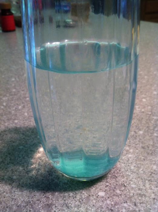

Replaced the brine valve and did a manual regen ~ 6 hrs ago and just watched foamy, salty "water" come pouring out of the kitchen faucet... no doubt the valve was stuck open, but apparently that wasn't causing the foamy/salty water...
Any other ideas?
That would be exspected on the first regen. The salt tank had too much water because the brine valve did not shut off. Now the water should be lower so once the unit goes through another regen, the water should not be salty.
No, just run off the water until it isn't salty or foamy.

No, let the system run normal cycle. If you fixed the brine valve everything should be OK
OK. Not doing another manual regen. Hopefully the problem is resolved.
Thanks for the help.
Just noticed the "foamy/salty" water sample I saved from last night has a bunch of turquoise sediment in the bottom of the glass.....
That's the color of corroded copper tubing. What does it look like in a clear glass instead of this blue?
It does look like copper corrosion. What is the PH of your water?
