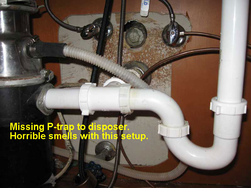

    And yet not all modern dishwashers have that. Sue's home had a new kitchen remodel, stainless appliances including dishwasher. She often had murky water in the dishwasher, sometimes enough to spill out the front when the door was opened. She had no "high loop" and no "air gap".
    The dishwasher was installed to the disposal, and the disposal had been plumbed without a p-trap. Wow! A complete kitchen remodel and they installed the new granite countertops with stainless undermounts without an air gap or a p-trap. Pretty gross!
    I went ahead and pulled the old antique disposer and installed a quiet Evolution disposer. Moved the drain in the wall and made sure that the disposer was now trapped before making it's way down the drain. The dishwasher now drains with an air gap on the counter top, and the bottom of the dishwasher is now clean, not murky. While I was at it, I added a frostfree faucet for watering outside to the piping under the sink.
    It's always better with an air gap!
