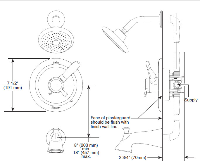

I'm about to install my new Delta R1000 rough valve. What size wood do you guys use for the stringer? By my arithmetic, it looks like it should be about 1.5 inches from the back of the studs. Shower framing is 2x4s, 1/2" permabase, Kerdi, 1/4" thick tiles. Does my math sound right?

The valve should have a rough in guide. Its black plastic and snaps onto the brass body. The finished wall should be flush with the guides front edge. I use a 2x4 or a 2x6.
Remember to orientate the valve correctly...it has and up and down.

Does Delta make a 1000 series? I know they make a 10000 series cuz I have one. I know you can also download the instructions from the internet cuz I did just that. It spec's 70mm from the front of the plaster guard.

1.5" from the back of the studs doesn't mean anything. The valve should have came with a plastic rough in guide. You set the valve in the wall with the front edge of the black plastic guide so that it will be flush with the finished wall.
Its really that simple.

All of these valves have a min/max on the rough-in. If it is installed with the finished wall between min/max or the rough-in plaster guard device, the trim will fit BUT, if you are at one end or the other, you MAY NOT LIKE IT! So, temporarily, put it together with the trim to see how much of the shaft/handle you want sticking out, then measure, and mount the valve there. There are LOTS of people here that have posted complaining about how it looks (not how it functions) because they didn't mock it up first. To the manufactuer, if it fits, it's right. To the consumer, they usually, don't like it at either extreme. The engineer's version of min/max may not meet the fashion design sense of the user. CHECK IT FIRST!

We do not use metric in the USA. But if we did 7 cm would be easier to read on the ruler. When installing any recessed valve, you measure from the "face" of the finished wall back, because that is the only "positive" measurement you have.

The min/max on the instructions just guarantees that any of the compatible trim will fit, not how well it looks. As long as you can get enough of the trim screws into the body and hold things on properly, and can get your hand on the handle without pinching or things rubbing, it will work. Someone with arthritis might like it further from the wall since it may be easier to grab and turn. Another thing with that rough-in valve...since it is used with lots of their trim, if it isn't within their min/max, should you decide to change the trim later on, it may not fit if you wanted a different finish or style later on...you'd have to move the valve, which could be problematic.

Mock it up...the instructions will tell you how to make everything fit, but you may not like it at either the min or max. Keep in mind that there is no cure for a valve out too far, and the one for when it is in too far doesn't always look great (some valves have a deep wall extension kit, not all). But, if you can place the valve where it is within the min/max, everything WILL fit...just that it may stick out further than you want it to for aesthetics.

SOmewhere in the instructions, it will define the min/max, which on that one, may be the slots, but I do not remember. Yes, I'd put the trim on, adjust it so that you can both get the screws in and the handle sticks out the distance you want and it looks good, then mount the valve where it is required. HardiBacker is 7/16", 1/2" dryall is really 1/2" (except on the tapers), but you'll have at least that difference in thinset to make it up. What you don't want, is to be so close to either the min/max that if you have a little variation in finishing out your wall stackup, things no longer fit. Most people like less of the handle shaft sticking out, so having the valve deeper in the wall looks best to them...just don't make it too deep, or the handle will bind and/or the screws wont' reach, or you'll have trouble reaching around it to grab!
