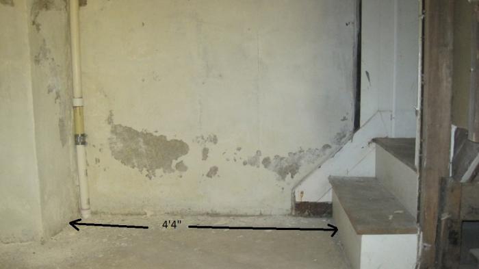

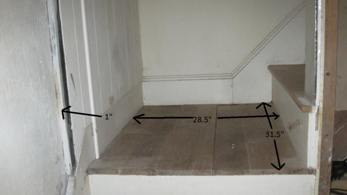

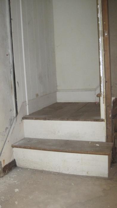

    I am finishing my basement (1950's house). I want to put insulation on the wall and then frame it. It looks like there is no enough space at the lower end of the stairs (refer to the photos please).
    I have 3 choices, I think. They are followed:
    1. no insulation or less insulation in that area;
    2. make the turnning area even smaller; But it may be too small by cutting another 5.5" from that small area.
    3. make that 90 degree turn one step early (when you go down). That means there will be 3 steps (now is 2 steps) to the basement ground after the 90 degree turn.
    Which way you think is better? do you have a better solution?

    You cannot take out a step unless you can re-space all steps without making the riser height greater than 7-3/4". (IRC)
    What you have there now appears to be bead board over furring strips. You could switch to 2" EPS foam board with furring strips topped by drywall, making the wall less than 2" thicker overall.
    For such a small job, the EPS makes the most sense to me.

    Are winders allowed in your area? You could replace the landing and the step above it with three winders if you have the headroom.

    Pfft! I'm not trying to wind you up. They are wedge (pie) shape treads that wind their way around.
