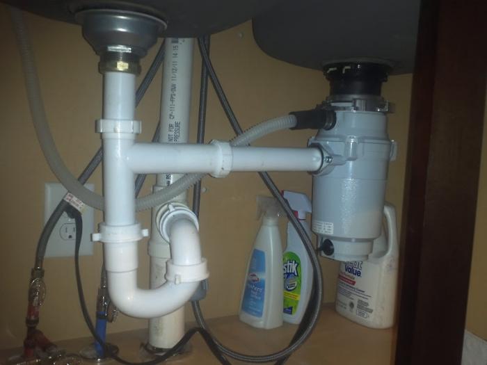

I just moved into a brand new house a week ago. When using the sinks under normal use they work fine. However if we plug one of the sinks and fill it the sink will not drain properly. The filled sink will empty into the sink next to it as well as into the dishwasher. Eventually (hours) the sinks will drain however this usually takes all night. I'm getting ready to contact the builder and plumber for the house, but before I do i was hoping for some advice or tips on what might be happening.
Essentially I'm 99% positive nothing fell into the sink stopping it up as this happened the first time we filled the sink. UNLESS something fell into the sink when the builder was working in the house. I'm more inclined to think the sinks are not plumbed correctly however I wouldn't rule out a stoppage as well. I'm a complete noob when it comes to plumbing so I'm not sure what a Y connector or vent or any of that stuff is that is required. Attached is a picture of the plumbing.
Thank you ahead of time for taking a look and offering your opinions!

Well unless it's an illusion you don't have proper slope between the disposal and the trap...
skeeterflea
Tennessee
I took the picture from the left cabinet. I couldn't get far enough back to take the image straight on with the cabinet divider in the way. But that's a pretty level pipe between the disposal and the trap. I can find a level and shoot a picture of it. Should the disposal be higher I guess?
*EDIT* Well it's kinda hard to get my 6" level on the pipes but the disposal appears to be a tad higher. Maybe a centimeter or so. What should the proper slope be?

I don't see anything there that would cause one sink to back up into the other. The plumbing there looks good.
Your clog is in the main 2" line that is going down through the floor.
If the house has a basement or crawlspace, there might be a cleanout in the piping below the kitchen.

The vent pipe going up between/behind the sink basin-- is there a cap on the top of it, or does it go into the wall?
I was assuming there was probably an AAV there, but I shouldn't assume such things.

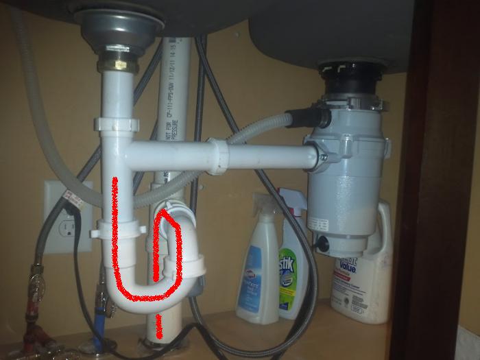

If the slow draining occurs with both sinks, odds are it's something in common with both sinks. The common section of the drain is what is indicated in red. Check for clogs either in the trap, trap arm or below the Tee

I assume that is an AAV behind the sink, and your drain line may be obstructed, (but is full of standing water for some reason). Slow running water will allow air trapped between the trap and the standing water to escape. When the sink is full of water its weight prevents that from happening and the sink cannot drain. First you have to find out WHY the pipe stays full of water, and then fix it. IF the sink had a proper vent, you would still have the water problem but the sink would drain.

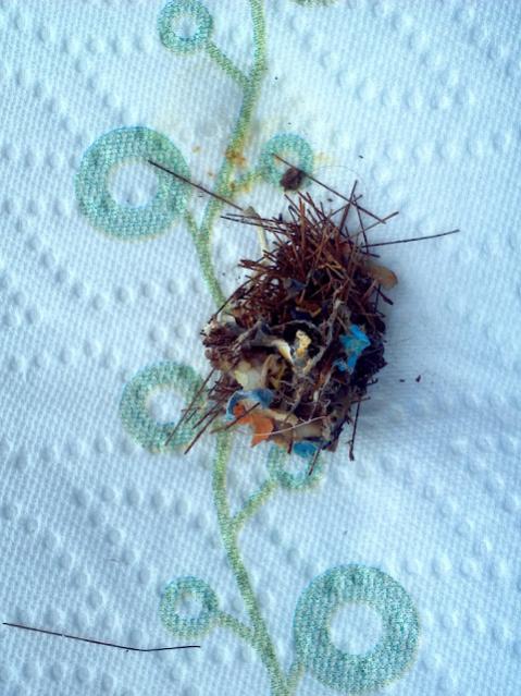

Thank you everyone for your assistance. You all were correct that there was indeed a clog. I want to state for the record that our use of the disposal was minimal in the one week we were here. We've probably used it three times for scraps that were at the bottom of the sink after doing the dishes. In my defense I'm a stickler about scraping off our plates and using the drain catches. I will post a picture of what I found in the sink in a few minutes. Then I will lay out my conspiracy theory...

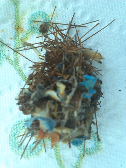

Here is the clog. I found what appears to be hot glue or silicone holding this golf ball size metal bristle clog together. I have no idea where the blue papers and other paper comes from that is stuck to the ball. The clogs started the first time we filled the sink with water to wash dishes. Regular use was not impacted. Only when the sink was filled with dirty dishwater did it clog up.
Any thoughts on this metal ball of bristles? I'm trying extremely hard not to believe it was planted there as a way to have the sink clog on purpose. Am I reaching too far here? Is it possible that a contractor other than the plumber was working with a metal brush and washed it out in my sink losing about 75 - 100 bristles down my drain? Sure. Is it possible that someone squeezed hot glue or silicone into the drain causing these to clump together and form what appears to be a virus of sink clogging capabilities? Given the bend in the catch I don't see how.
Those sort of look like bristles from a brush. They may have broken off the brush, maybe in a bucket, then they dumped it down the sink.
