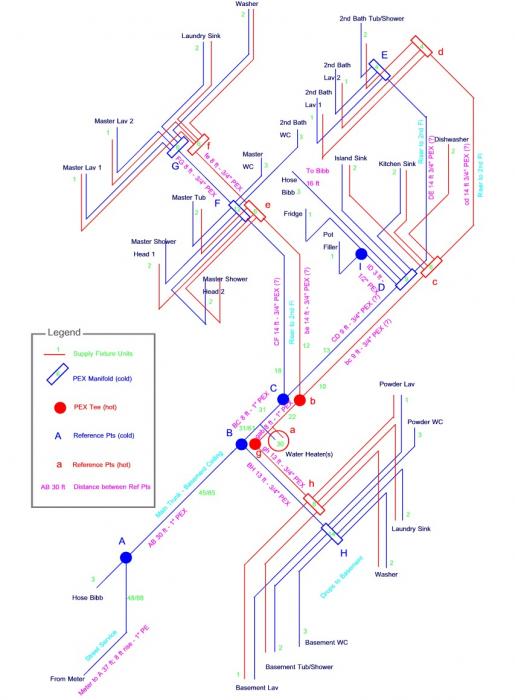

3500 sqft house with finished basement (1 bath), main floor with kitchen (2 sinks) and powder, 2nd floor with 2 baths including master shower w/ 2 heads and separate tub.
How big of a Tank water heater do I need? Model recommendations welcome. Or better to have 2 water heaters? main trunk is 1" how do I connect to tank? (ie can I get tank with 1" fittings?)

We will be using electric. I have access to an 80 gal tank in good condition from another house that I could use so if that would suffice that's what we'll do. The main trunk is supposed to be 1" according to calcs. I've posted a whole thread on the distribution system in the Plumbing forum but I can repost here the diagram if it helps. The 1" trunk is a small section essentially tying together three 3/4" main branches in the basement. (According to our calcs we have 30 hwfsu at the water heater with 80 psi and 100 ft max developed length that required 1" branch to serve it.)
The 80 gal tank has 3/4" connectors. I am still wondering about connecting that to 1" trunk... does it make any sense to 1" trunk w/ 3/4" water heater or can we change out the 3/4" connections on the heater or can we get a heater w/ 1" connectors??
Attached is the diagram.

How many bedrooms? I dont care how many fixtures you have,its the expected use that matters along with your cold water inlet temp. I read that that average cold water inlet temp for seattle is 41 degrees???? Thats very cold if its true.
You want to calculate your peak hour demand. Thats how much hot water will be used in one hour at the most active time in your household.
The number of bedrooms is indicative of how many people would be showering and washing clothes...etc etc. in a normal house. Thats how septic systems are sized......that and how many big tubs you have. I understand your not building a septic system but the principle is the same,its based off expected use.
As I said earlier, figure out what your peak load is: how many showers running at once, how many back to back, is there a big tub that needs to get filled, do you want to be able to be using hot water with the DW or WM running at the same time? Then, and only then, can you figure out what you need. Say all four showers are running at the same time, that's about 10gpm. 7-minutes, and a 70-gallon tank is essentially cold, especially in the winter when you need more hot to cold ratio to keep things comfy. Fill a 100-gallon tub, and it won't be hot when you get in. We can't tell you what you need until you tell us your intended use. Some big WH may have slow recovery, some have MUCH bigger burners, and can help to maintain temp with a modest output. Raising the WH storage temp makes the tank 'look' bigger, but once it's cold, it's cold, regardless. Where I live, I've personally measured incoming winter water temps at 33-degrees. So, my wintertime hot water needs is more stringent than someone living in say Honolulu when the water temp may be 70-degrees all year long. If you have a deep well, regardless of where you live, your water is likely cold.
If you figure 2.5gpm per showerhead that would be 10gpm. But not all of that 10gpm is hot water. lets say he has a thermostat setting of 120 degrees and a 70 gal water heater. The 70 gal water heater will deliver 70% of its capacity at the thermostat setting of 120 degrees.
With a showering temp of 105 degrees and the incoming cold water at 40 degrees the percentage of hot to cold would be 81% hot water. That means the 70 gal water heater with a temp setting of 120 could only deliver 49 gallons before the 81% hot water mix ratio starts to go up to maintain a showering temp of 105 degrees
81% of 10 gpm = 8.10 gpm of hot water flow at a temp of 120 degrees.
The 70 gal tank can only deliver 49 gallons at the temp of 120 degrees.
49 divided by 8.10 = 6 minutes and 3 seconds of showering before everyone of those 4 users start adjusting in more hot. At this point the 4 users would have 21 gallons of hot enough water to finish a shower at 105 degrees which would be equal to 2 minutes and 35 seconds. They would be constanly compensating from this point on.....unless they have a thermostatic valve and then the valve would compensate for them.
So a 70 gal tank with a thermostat setting of 120 degrees with an incoming cold water temp of 40 degrees could supply four 2.5 gpm showers at 105 degrees for 8 minutes and 38 seconds.

High-flow showers and heating hot water with electricity SCREAMS for drainwater heat recovery on the showers, independently of how many HW haeters or total volume. Even at 7 cents kwh there's a good economic argument in high-volume shower uses. (IIRC In Seattle PSE's residential retail rates are running more like 12 cents/kwh, delivered.) At typical one-showerhead flows it would roughly double the effective showering time, even for an electric tank (and turns a typical small-burner 40 gallon gas fired tank into about an hour-long shower at Seattle's incoming water temps.)
Sizing the tank volume for the anticipated tub fills is most critical, but you'll need to go higher than that if you anticipate other large draws simultaneously tub fills. Drainwater heat recovery may do wonders for shower performance, but does SQUAT for tub fills.
From an efficiency point of view the distance from the tank to the load counts. In an average CA house something like 17% of the total water heating energy is thrown away as "abandoned" hot water in the distribution plumbing. Locating the tank nearest the most-often used taps (which aren't necessarily the highest volume use taps) makes a difference. Insulating all distribution and near-tank plumbing (even the cold side) with 5/8" wall closed cell foam pipe insulation does too.
