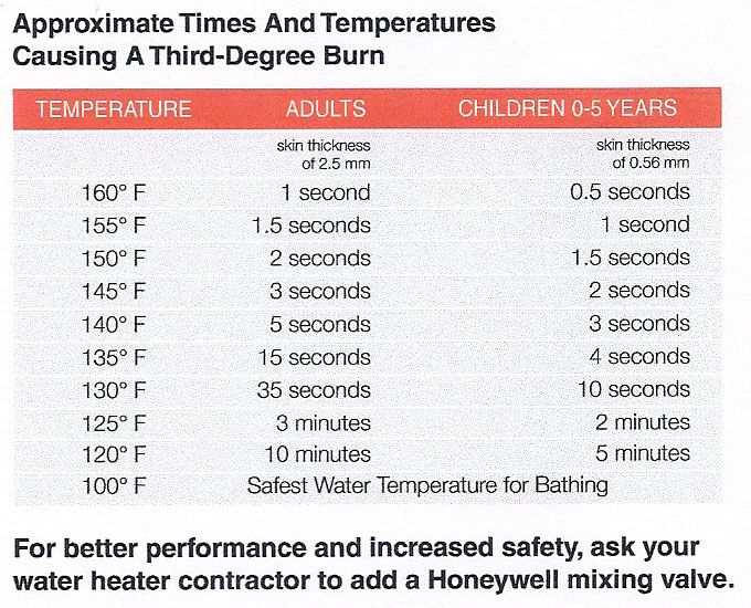

    Many plumbing codes require a tempering valve to prevent scalding if you have a tub that people bath in. A tempering valve takes the cold water and mixes it with hot water and dials it down to a suitable temperature.

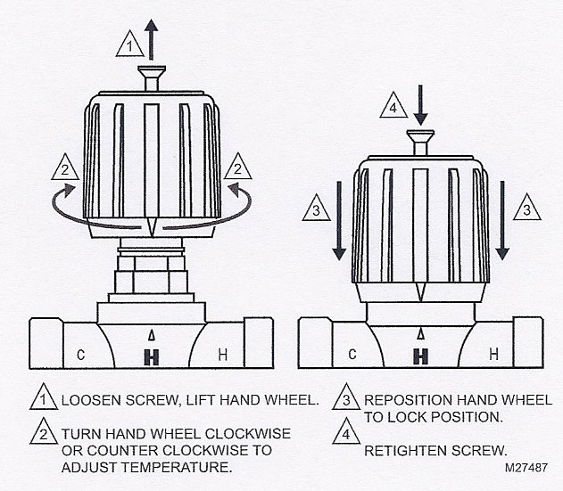

    Some adjust between 70 F and 120 F
    And you can also get one that does 70 F to 145 F

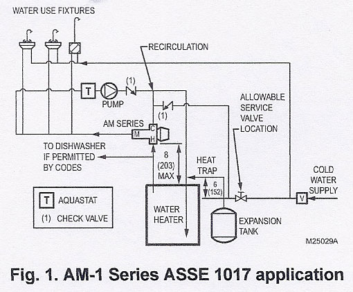

    Installing the AM-1
