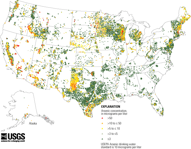

    FYI, I am not some dumb guy who read some info on the internet about water treatment and decided to voice my opinion. I bring 25 years of extensive knowledge to this board. I have current certifications, licenses, and have worked with equipment througout the world. Comprehensive water testing is not taken lightly anywhere I have been but here. And only in single family applications. Once the water supply is going to go to more than a few houses, most states consider it a small municipal well that does fall under stringent water quality testing. I guess the logic is that the worst that will happen is only a few people will get ill, get cancer, etc. Your knowledge is consdierable and appreciated, but when someone disagrees with you, you go on the attack. Maybe you have been retired too long and have been unable to keep up with current regulations and studies showing long term affects caused by contaminantes in our drinking water. The Arsenic issue is a simple example. Notice the map, it shows the naturally occurring Arsenic in ground water in the US. Arsenic is easy and inexpensive to remove from water, and until recently, it was unable to be tested to levels below 50PPB. Now we can easily test to the 1 ppb range and lower. The MCL was lowered in 2001 to 10 ppb due to the known negative affects that low levels of arsenic can have on the human body and the advances in water testing that made it easy to test below 50 PPB. Prior to then, the negative health affects were known, the testing technology had not been readily available. The MCL will likely be revised shortly to 5 PPB. Modern medias and techniques have made these numbers esily attainable.
    So the best I can tell, you would go to a house that has a well, and because you didnt get a rash on your tongue when you tasted the water, it is safe for long term consumption? The well a few miles from here has been in use for 20 years, and the homeowners are fine so... The data is in about naturally occuring and man made pollution in the ground water supplies. Why would you risk it?
    I ask again, with todays readily available technologies would you even consider going to a house that has a new well, doing a few basic tests, hardness, iron, tds, pH, and then install some basic equipment and tell the customer their water is now safe for drinking or bathing? Bathing includes showering which atomizes the water molecules and are then breathed into the lungs.
    I will answer the question for myself. Yes, I used to do that, 20 years ago. I would not even consider it today. Have you considered the liability of not doing proper and certified testing?
    Check out the newest World maps of Fluoride and arsenic in ground water if you want to see how prevalent this issue is. The US looks great compared to Africa and parts of Europe.

    The northeast is notorious for high levels of arsenic. Not testing would be tantamount to criminal negligence
