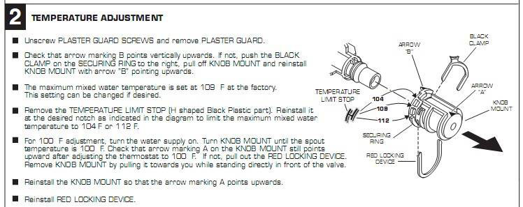

I don't know anything about plumbing -- or maybe I should say that I didn't know anything before, now that I've started lurking these helpful forums ;) --, but I got to learn, because I want to make the right choices and I assume that the plumber who'll install my new shower set won't research these things. So, I've been looking at American Standard thermostatic valves and I had some questions about them.
1. Is it possible to use both port (shower and tub) on a valve like the R520 if I use a stop valve/volume control on that second line?
I've searched the forum a bit and I found this answer:
You can use both ports but you will probably find a noticeable water temperature difference.
Is there anything else I should be aware of? Can both ports be used at the same time?
2. American Standard thermostatic valves are limited at 112° F at the factory, which seems crazy to me. :/ Reading the product description, I thought that my plumber could circumvent that by adjusting the 100° F "baseline" to, let's say, 106° F, giving me a new 118° F maximum.
Am I right? Could this cause a problem?
3. I've been reading a lot of comments stating that you could/should install a thermostatic valve using the tub port regardless of the application.
If using for shower only install the body upside down to eliminate future problems and give maximum flow. DO NOT, install the cartridge upside down, however.
Why do the manufacturers show the other configuration in their diagrams, though? Maybe they want to sell their bigger models... If a valve is rated at 9 GPM, is it from the shower outlet? And if so, what can we expect from the tub outlet, then?

The upside down recommendation is NOT for thermostatic valves because it has no bearing on them, because they have full ports on both sides and use volume controls to regulate the flow. ANd it does not apply to all manufacturers, only those whose valves have 180 degree symettry. Also notice that I wrote "for shower only applications", not "regardless of the application". A thermostatic valve, without an on/off function, has a "open body" so both ports access the same amount of water.
db65
Montréal, QC
Like I said, this is all new to me. Furthermore, English is not my first language, so I might have worded things in a weird manner, but I really thought this applied to thermostatic valves too! I'm so glad you're there to clarify and explain that, hj. Thank you. :)
I assume I could then use both ports and put a volume control on the "tub" one. This way I wouldn't have to use a diverter and it would be a more flexible installation.
What do you think about the temperature limit? If it can't be changed, I'll have to buy another brand.
