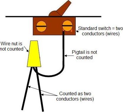

    OK, so I was looking in a box today because I thought I heard a noise. There are two light switches and one receptacle on this box. The one light switch has a red wire fastened on a screw at the top and a black wire fastened to the screw at the bottom. The other light switch is the same however there are two black wires on the bottom screw.
    There is no evidence that I can see of any arcing, burning or melting in the box. I am not even sure if the noise I heard, a clicking noise, was from the box (but it was in that vicinity)- anyway my question is: are there any issue with having two wires on one screw on the light switch?
    I know nothing about this stuff so I just look at it, never touch it or take it apart- I learned that lesson the hard way a while back.
    Any thoughts?
    Jan 2008
    2,719
    2 wires stacked under the head of a screw is not a proper installation.
    A wire nut and 3rd short piece of wire should be used to make a "pigtail" connection.

    Jan 2008
    2,719
    It has probably been like that since the house was built and it hasn't caused any issues. Are you going to pull out all of your switches and receptacles to inspect them? Are you doing this with the power on?
    I would not consider it to be a issue worth calling in an electrican, but when the switch goes bad or if one day I was changing colors, then I would fix it when I installed the new switch.
    19,402
    New houses are required to have arc fault circuit breakers...if you had them, they might trip. Is there any evidence of arcing (often black or pitted) on the switch? If so, fix it. The average switch doesn't have a big load on it, so the wires don't heat up and cool off with the load changing much. If it was controlling a big load, you'd likely have a problem as that expanding and contracting from the heat tends to loosen the screw...with one, properly tensioned, it'll stay tight; with two, probably not.

    If you're replacing a 3-way with a new 3-way, they are often labeled so making the new connection is fairly straight forward. BUT, keep in mind that, depending on how it is wired, it may not have any neutral wires in the box and none would be connected to a mechanical switch. You may need to run a new cable to get one. For a non-electronic device, all you need is common, traveler, and switched (can't remember what they actually call them!) - no neutral is switched, you always switch a hot.
    Plus, it is NEVER a good idea to have two wires under the same screw - it's impossible to get the connection properly torqued down, and it will loosen eventually, creating problems.
