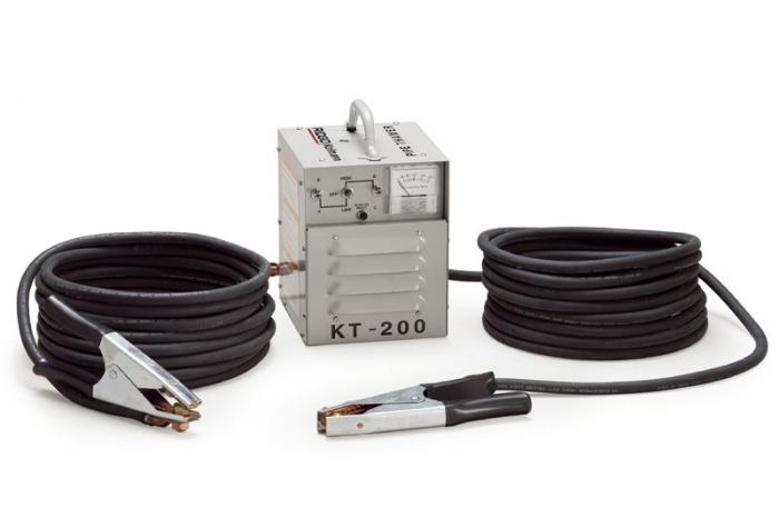

    7) If your main line has frozen, they do have pipe thawing devices that can clamp on, using electricity to run a warming current to thaw, this only works on metal pipes. If you have plastic, you will need warm air.

    Anyone ever use the fire hydrant and inside piping to thaw a water main? I've heard of it done but never attempted or seen it done personally. I have heard if you wish to do ityou have to make sure you remove the electrical ground for the house if it falls with in the clamps of the thaw machine. Just curious what you guys think of this.

    I've heard that in PA they use welding machines to thaw inground copper pipes by passing many amps through them.
    25,679
    The closer the two clamps can be positioned to each other, and the less "dirt" the current has to pass through, the more effective a thawing machine or a welder will be. BUT, it the pipes have frozen and burst, so there is a gap between the ends, a welder can create an arc and burn the house down.

    Thawing pipes with a welder is a common practice but it is really hard on the machine. It is very easy to exceed the 100% duty cycle rating of a welding machine doing this.......You can hurt the engine or easily damage the windings or wiring in the machine.......Big machines can do it a lot better than small but they should not be turned up to max output.....
    Some machines have warning labels on them that say DO NOT use for thawing pipes.......Larger Diesels are in the $20K range new for a Miller or Lincoln.......they can do the job as they are usually rated at 300-400 amps at around 30 volts DC.....and at 100% Duty cycle which means continuous with no rest period needed....

    This gets interesting; 1" ID copper pipe is equivalent to heavier than 0000 AWG copper wire. That's a dead short in my book.
    And if you have a welding machine and a storage oscilloscope you could check your resi. circuit breakers [from behind a shield]. Nah, just kidding.
    25,679
    It IS a dead short which is what creates the heat to thaw the frozen line, and why it is hard on the welding machines. But then, a stuck welding electrode is also a "dead short", and the machines survive that.
