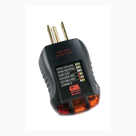

    These are both cheap and handy, but will not show if the ground pin is wired to the neutral.

    Can one determine that if one goes to the panel assuming one is competent, and after shutting off the power to the circuit (or better, the whole panel) and then pull the neutral and ground from the bus bar(s) and test for continuity across them?

    Final Determination:
    The electrician determined the outlet was wired incorrectly (hot and neutral reversed). He had a device similar to the one pictured in post #9 (not the multimeter). He used this on the outlet and it only told him "no ground". He said that it wouldn't tell him if there was reverse polarity. He then checked a nearby GFCI with the same plug-in device which said that the GFCI had a ground.
    The outlet that the refrigerator was plugged into was approx. 6' away from the GFCI. The electrician used a single strand of 12-2 wire and pushed the end (stripped of it's insulation into the ground opening on the GFCI outlet. He then used his multi-meter to check the voltage at each opening of the outlet. The multi-meter showed voltage at the wrong side of the outlet.
    He pulled the outlet and it was in fact wired backwards. The wire is 2-wires (each individual wire insulated) wrapped in a black insulation.
    Bill
