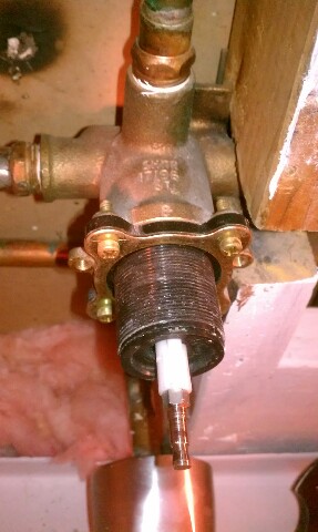

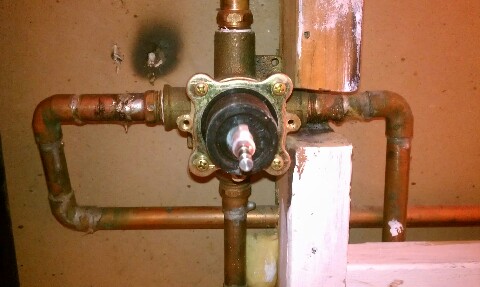

    With PP stamped on the valve I'm guesing it could be Price Pfister. Is the stem that the handle slips onto a black plastic material? The valve I'm speaking of the stem pulls in and out to turn on and off. To adjust the temp you turn the handle left for hot and to the right for cold. I'd love to see a pic just for kicks.
    9,003
    ASSE 1016 is the spec. for pressure balanced valves, by the American Society of Sanitary Engineering. Other than that it tells us nothing. Not likely to find ANY useful identifying numbers on it.....need photos of cartridge and trim pieces.

    DIY Junior Member ConvexLes's Avatar
    Jan 2012
    Colorado
    9
    Good grief, I hope this posts, AND that its the right picture. I've been trying to post one since yesterday, its this phone...and the file is too big.
    Jan 2012
    Colorado
    9
    I haven't touched it except to take off the trim...I've just been working around it. I don't dare take it apart, because I cant tell if it has screwdriver stops.... But I don't think it does. It doesn't leak at all as long as I leave the trim off... Which seems puzzling to me. We do have minerals in our water...if it was only a matter of replacing a cartridge, or something...it might take some of the pressure off temporarily, but if its not really worth repair... I'll replace it now, then worry about getting trim for the new valve later.

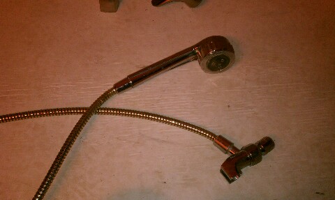

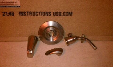

    Oops. Needed to track down the original showerhead, which I liked better anyway... I never used it more than a couple times.Someone asked see the trim. Trying to post that now...
    The hand shower cost ten bucks. I hated it, but got into the habit of just using it all the time because of my dog. He had to be kept really clean all the time since he was with me in public everywhere. That's why I need an extra shower outlet... The way I was doing it wasn't exactly working that well. Plus, I need the handshower line to reach all the way across the tub. Especially now that its not the same dog... He's not used to taking showers with me while were in a hurry quite yet. Lol. (Up. I'll be researching about ways to make sure everything gets truly waterproofed too, as soon as these valves are done.)
    Oops, and no. The volume controls only twists.... It doesn't pull out to turn the water on. (Spell check is not working for me today.) You move the handle CCW to increase water flow.

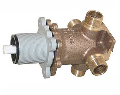

    23,512
    Default pfaucet
    It is a PfisterFaucet pressure balanced valve and you can get MANY different trim items for it, in several finishes, but they have to be designed for that type of valve body.
    It could be the Price Pfister
    0X8-310A valve body

    I still think its a price pfister. There is no name printed on the face of the showerhead or round plate?
