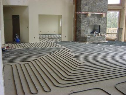

    All heating systems are definitely not created equal. One of the most desirable, radiant heating is unmatched in comfort and performance. Incredibly, some forms of radiant heating actually trace their roots all the way back to Ancient Rome. Technology, of course has added countless improvements ever since.
    Radiant heating is a technology for heating indoor and outdoor areas. Heating by radiant energy is observed everyday, the warmth of the sunshine being probably the most commonly observed example. Radiant heating as a technology is typically more narrowly defined. It is the method of intentionally using mostly the principles of radiant heat to transfer radiant energy from an emitting heat source to an object. Designs with radiant heating is seen as replacement for conventional convection heating. But also as a way of supplying confined outdoor heating.

    Those extolling the virtues or radiant heat should do a little more research. While radiant ( pex systems ) can offer comfort, they also cost 2 to 3 times more to install, and will not necessarily save one single cent in energy consumption as compared to say baseboard heat or even an efficient forced warm air system. Many folks (professionals and non professionals) have been sweet talked into the radiant revolution but few are willing to run the numbers. In most cases a radiant system will take more than twice as long to realize any cost savings over a conventional system and many times will require much more maintenance due to the amount and complexity of the system. However I would like to thank the OP for spamming us in such a thoughtful manner.

    A properly installed radiant system doesn't require any more maintenance than any hot water heating system - still uses a boiler and instead of non-functional (at least for heat generation) pipes connecting things, the pipe IS the heat generating thing. A warm floor also means freedom to put your furniture anywhere, and your pets will LOVE it. It can limit or decrease the efficiency if you want carpeting everywhere, but if designed for that, you can get the heating. Yes, it is more labor intensive to install. You do it because you want it, not because it is more efficient. But, it can be, since you will generally be more comfortable at lower temps, but don't count on it as a major selling point. With a condensing boiler, you'll be in the condensing mode much more often with a radiant flooring system than you would be with typical installation with radiators.

    The KEY is to do an OPEN system, combined with your hot water piping. You need only one pump and one check valve. Absolutely no complexity, no crud in leaky ducts, no radiators taking space, and warm feet and very happy dogs, and a place to dry your shoes and coats. The cost becomes labor to lay the pipe [cheap], the manifolds, one pump, and one valve. far less cost than forced air. Now if you need AC, you have ducts also, or wall units up high in dedicated holes, so some loose the incentive when they get a quote from the clown with 8 pumps and zone valves and anticipators.
