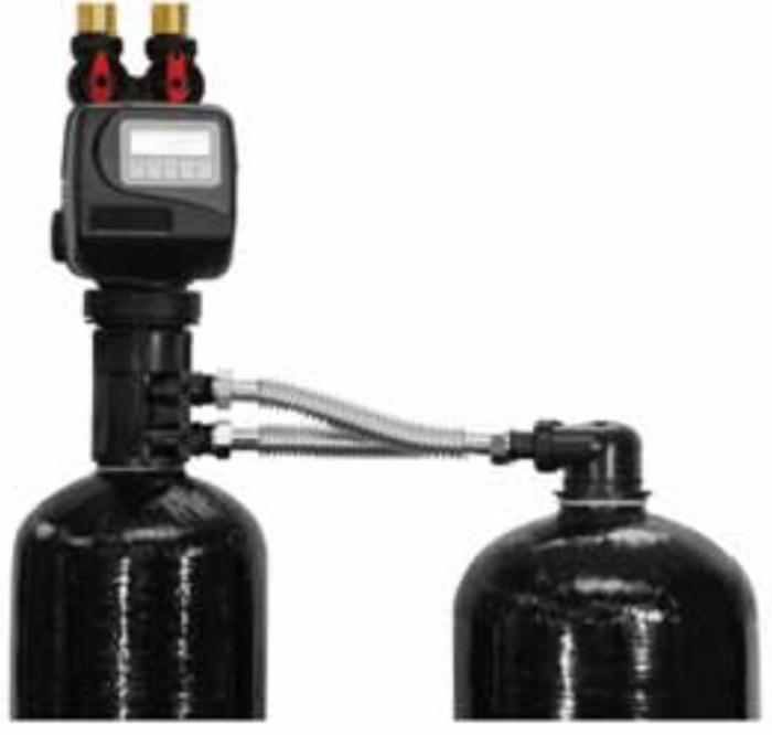

    Here is my recommendation, this is a very unique system designed specifically for your application.
    Stage 1: Minimum, A 9x48 Iron and hydrogen removal system utilizing Pyrolox. Please note that your pump needs to be able to pump 11 GPM to properly backwash the Pyrolox.
    Stage 2, an parallel tank system with softening resin in tank 1, and Tannin selective resin in tank 2. This unique design eliminates the need for seperate regeneration cycles for the softener and tannin systems. The softener regenerant wast (chloride) is used to regenerate the tannin resin.
    This design requires the addition of a resup feeder to lower the pH of the brine water so as to prevent the precipitation of the caco3 in the anion resin bed.

    Ok, that second stage thing is all new to me. I'll need to get more info (and pricing) to get that one around my head. What I get so far is that they both regenerate at the same time, but the softener gets brine and the tannin remover gets chloride. So is there going to be a chloride tank, or do I need a retention tank for chlorinated water? Also, other than saving on buying two valves, why is this better than having the two tanks independent?

    The parallel tank design is quite simple.
    The first tank has softener resin, which is required (extremely highly recommended) prior to an anion resin bed to extend the life of the anion media, Specialized anion medias are used for sulfate, Tannin, or nitrate removal. The second tank has tannin specific resin.
    When the softener needs to regenerate, the Cation water softening resin uses the sodium portion of the salt (sodium Chloride) to regenerate. The Chloride portion of the brine is typically just a waste product. in this design, the waste product will then go through the Anion tannin resin as a regenerant.
    Typical tannin systems are seperate because the complexity of designing a system to do both has been problematic. With this special adapter, the design is actually quite easy.
    The main design flaw with this system is the need to drop the pH in the brine tankk so as to minimize fouling of the Tannin resin that can occur due to the high caco3 load the bed will see during regeneration.

    Ok, I think I get it. First, we clean out the Iron using Pyrolox (instead of greensand which just has a coating of pyrolox), then we clean out the hardness (CaCo3) with a regular resin, then clean out the tannins with the opposite type of resin. We want to clean out the hardness first because the tannin resin is harmed by the hardness.
    At what point does the Sodium get separated from the chloride though?
