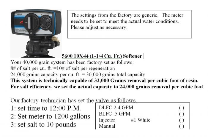

    Gary, Perfectly stated. The technical aspects of softening is where it gets tough, especially super low salting systems and pushing reserves to try to get ridiculoous efficiency standards. A standard system with a proper reserve should regenerate with 15% or more capacity left, which in turn will give you the additional 10+% overhead on the grains/lb salt. Only in systems that are set extremely accurately and in a twin alternating design does this equation have the slightest potential to not work, even so, the hardness is always bumped up a few grains allowing for more safety factor.
    The only problems we have are when people run the capacity to tight, which emphasises the hardness bleed. This is most common when people who have a Hach 5B test kit and read too much on how to make a softener the most efficient it can be. You know the customer, the guy who tells you how he adjusted it so it will use less salt because he read online....
    This is the way I would set it up since he has a 5600. I have inserted our programming guide we send out with our 5600 system.
    5600 10X44 (1-1/4 Cu. Ft.) Softener
    Your 40,000 grain system has been factory set as follows:
    8# of salt per cu. ft. =10# of salt per regeneration
    24,000 grains capacity per cu. ft. = 30,000 grains total capacity
    This system is technically capable of 32,000 Grains removal per cubic foot of resin. For salt efficiency, we set the actual capacity to 24,000 grains removal per cubic foot.
    Our factory technician has set the valve as follows.
    1: set time to 12:00 P.M.
    2: Set meter to 1200 gallons
    3: set salt to 10 pounds
    Assembler_____________
    This may need some fine tuning for your application but it should help.

    Wow! That was informative and very helpful. Thanks.
