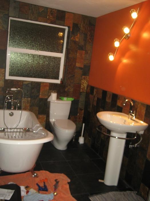

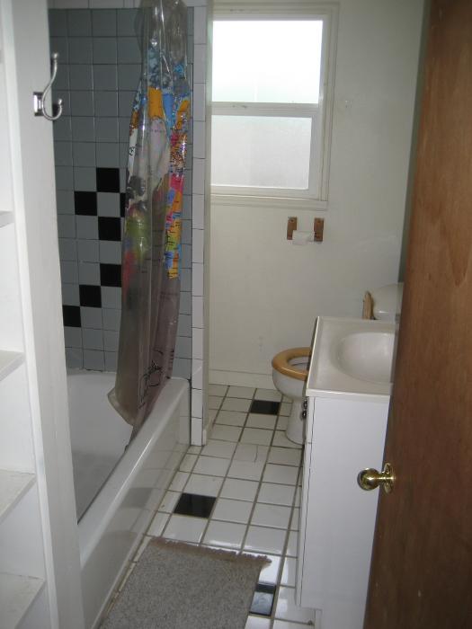

Terry asked for a pic of the Aquia 2 when they installed it, not sure if he ever posted it, but here is a shot of my bathroom, before and after :)
BEFORE
Almost after (excuse the renovation materials on the floor):

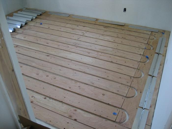

on my first floor, i pretty much cut 6" slats of plywood spaced them 3/4" apart and used a router to make arches in the plywood so they weren't really sleepers, it was essentially custom routed plywood as you can see here in the pic.
I did make sure each CBU board NEVER touched or ended over a gap.
