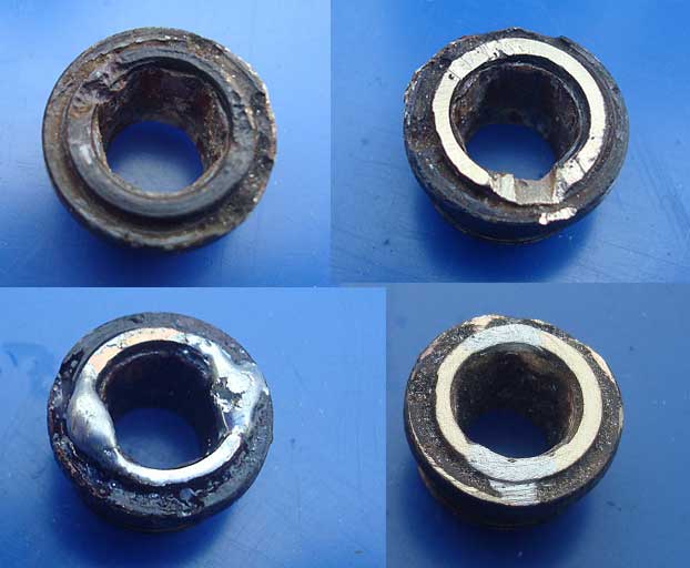

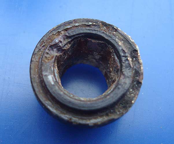

    Alot of homeowners think they can just replace a washer and that will stop the leaking faucet but some faucets contain a faucet seat. The surface face of the seat should be smooth and flat.
    As you can see this seat is not smooth or flat and a flat washer would not have stopped the leaking tub faucet.

    In a pinch for a temporary repair this faucet seat could be resurfaced. Its a fairly simple proceedure with common tools.

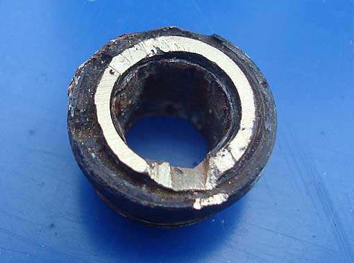

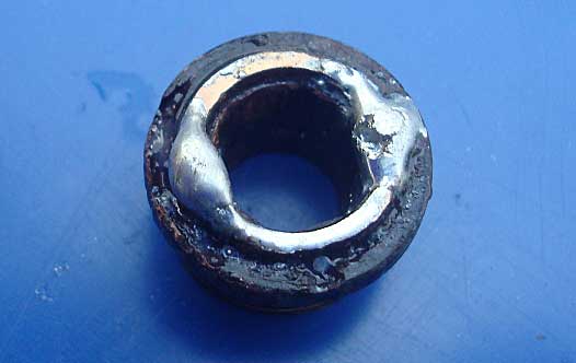

    First you remove the bad brass.....with a file. Every plumber should carry a file on the truck right?
    Then you apply a lil bit of flux and some lead free solder. a bit of skill is involved here not to get the seat too hot but hot enough to allow the solder to stick.
    You allow that to cool and then use the file to make the seat smooth and flat. Spin the seat as you file to keep the surface of the seat flat.
    I did not spend very much time with this seat because I didn't have to use it in a pinch or for an emergency,I had the replacement seat with me. if I had to use the seat I would have spent a lil bit more time dressing it out to smooth finish. I spent about 5 minutes on the seat in the pic from the first pic to this last one.
