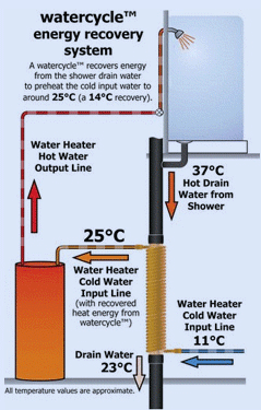

    With that in mind I've been thinking of installing a heat recovery drain system for an upstairs shower. I'm currently thinking of "Power Pipe" but I'm sure there are others.
    First, does anyone here have any experience with these good or bad. And second: Typically one would install this in line with the cold supply for the hot water tank but since my tank is a good distance from where the heat recovery unit would be, it would be simpler to install this in line with the showers cold supply. I'm not sure if I would need a fancy mixing valve to make this feasible. Any thoughts?

    Here is a 2007 study by the Canada Mortgage and Housing Corporation.
    Drainwater Heat Recovery Performance Testing at CCHT
    The in situ effectiveness testing looked at how long the shower could be run before the water temperature dropped below 37°C (98.6°F). All DWHR devices resulted in significantly longer hot water availability times than the benchmark time of 28 minutes. Configuration A results ranged from 39 minutes to 62 minutes. Configuration B results ranged from 53 to over 75 minutes.
    Some Canadian provinces are offerring rebates for these.

    Apparently the "technology" is that the drain water tends to flow in a thin film on the inner surface walls of the drain pipe, providing a lot of surface area for thermal transfer.
    As with all research, the data raises as many questions as they answer. It seems they are using a starting shower temp of about 105º, but run until the shower temp drops to 98º?? That is not acceptable to most people. If anything, I personally tend to dial UP the temp after a bit of time. I normally take a pretty short shower, but if I feel like a "steamer" then 98 doesn't cut it!
    All in all, it does look like there is some savings worth pursuing. The websites do seem to show that the system must be vertical, so retrofit may be difficult.

    Heat transfer depends on numerous factors, but the delta T, or difference in temperature is a big factor. Water does tend to run down the sides of the pipe, even when vertical, rather than falling down the middle of it, so you end up with a thin film on the maximum surface area. Then, by splitting the supply water into multiple square channels like one of the recovery systems does, you tend to maximize the heat transfer. By warming the inlet water to the WH, you're decreasing the load and making it look like a larger WH. If you warm the cold into the shower, you could use slightly less hot and achieve the same temp, but you would have a much bigger variation and still likely have to start with a hotter input. This is a situation where a thermostatically controlled valve would have advantages, even as the hot cooled off, the valve would be adjusting the hot/cold mix to try to maintain the set temperature. I think I'd put it in the cold supply to the WH and then make sure I'd insulated all of the piping to retain the heat gained.

    Incorrect. This is the most common layman's misunderstanding of how heat transfer works: "in contact long enough." It's not the residence time but the heat transfer coefficient and area, along with the driving force (delta T). Liquid film coefficients are quite high.
    If you look at the designs of the drainwater heat recovery units they can achieve reasonably good recovery. The layout is typically one of countercurrent, falling thin film exchanger, often with a multi-parallel path coil in close contact on the other side. Combine these with the excellent heat transfer properties of water and you have a functional design.

    The main shower in the house presents and ideal installation as its drain immediately drops one story to the main drain below grade. Because the concept works best when drain flow matches inlet flow I wouldn't bother re-designing the main stack to accommodate one of these as the shower is the only load in my house that matches the basic criteria.
    The only question in my mind is can I use the drain waste heat recovery unit to warm the shower's cold water supply or with this present a problem for the mixing valve?

    Splitting it into "multiple square channels" may make it transfer heat better, but would be disastrous for a shower drain, especially when it comes time to clear the debris out of those channels. Did any of the evaluations consider the degradation caused by soap and hair buildup on the walls, which would be exacerbated by having small channels? Also, what were the respective flow rates? High flows would not allow the "hot" and "cold" waters to stay in contact long enough to get the temperature differentials the diagram shows. The discussion might be academic, because a search for "Watercycle" does not produce any results so they may not be a factor any longer.
    For clarification, it is the water supply line that is split into multiple channels not the drain. The drain portion is simply a straight cooper pipe with an i.d. of 2", 3", 4", or 6" (Available PowerPipe sizes)

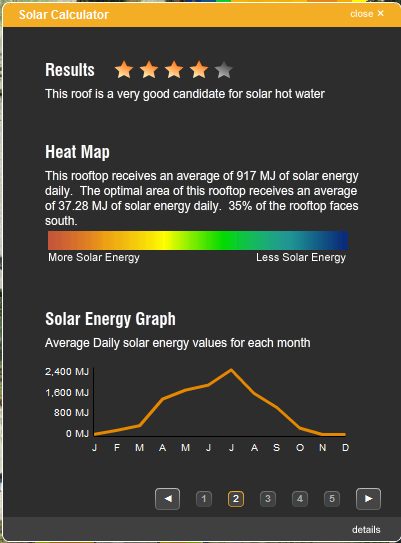

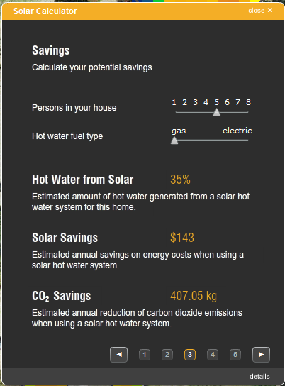

    Your recovery time may be shorter but I can see no cost savings here. It strikes me as an inefficent use of space and money. Given that your "holding tank" will be absorbing BTUs from a conditioned space, a space that you paid to condition, there is no net gain in BTUs. You're not capturing lost energy, you're mearly transfering energy.
    Your money might be better spent investigating solar domestic hot water. The District of North Vancouver has already done you the favour of estimating your savings based on your location's solar exposure. See their mapping applications at http://geoweb.dnv.org/
    Here are the stats for your house.

    Solar BC has grants available and I expect you have the expertise to install it.
